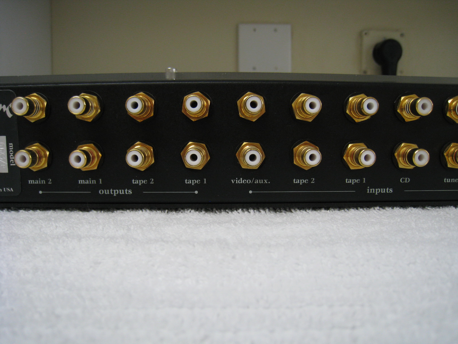

Hello,
I have a preamp that has four banks of micro switches for gain and input impedance. They are adjusted for my Denon DL 103R.
I have decided to add another deck that also has a 103R but comes with a Denon AU-320 step-up transformer.
My question is, should I reset the micro switches to 0 when inserting the transformer or will it automatically defeat the present set-up?
Is there another way to connect the transformer to avoid the cumbersome task of setting the switches back and forth when I switch from turntable A to turntable B?
Many thanks,
Horacio

Does the transformer output use the MM input to the preamp perhaps? If not then yes you'll probably have to reset the switches each time. They tailor the preamp to a particular cartridge.
Other approaches:
1) remove the transformer
2) add a similar transformer to other deck
3) get a 2nd preamp
BTW: You mean DIP switches, not microswitches. This is a microswitch: Z15GW2BOMI | IP00 Snap Action Limit Switch Roller Lever, NO/NC, 500V | RS Components
Most likely yes.
Why preamp is it? That will help answer the question more accurately.
No.
It is a Klyne Series 6
The Klynes were excellent preamps of their era.

Chaps,
I should have been more clear regarding the use of the Denon transformer, it seems that I opened a can of worms here.
A friend gave me a Thorens TD 125/SME/3009/Denon AU320/DL-103R. I already have a great deck but wanted to try the 320/103 combination and not delve into what transformer is better.
The phono preamplifier for System Six is factory-installed in the 6LE3.5 / P model. The universal application is obtained with an adjustable gain of 37, 50 or 63 dB at 1 kHz. The input impedance is adjustable between 100 and 47K Ohm. An adjustable high-frequency contour network is incorporated into the cartridge loading circuit which has a load dependent on the frequency of the cartridge to dampen the high-frequency resonances of the MC cartridges. It has a superb head amp with unlimited asjustments.

The DL103 R ha 14 ohm impedance.
The 320 is very ggod but I think you must adjust the reflected impedance.
Now if you have 47k on phono you get 470 ohm reflected on primary.
The phono has the switches and if you are able to set for 22 kohm (p.e.) you will get a better match. Also 15 kohm ( 150 ohm reflecetd9
In case you can use a T adapter on cable goes to phono stage so it is possible to put a male rca jack with a resistor soldered.
in parallel with 47k
