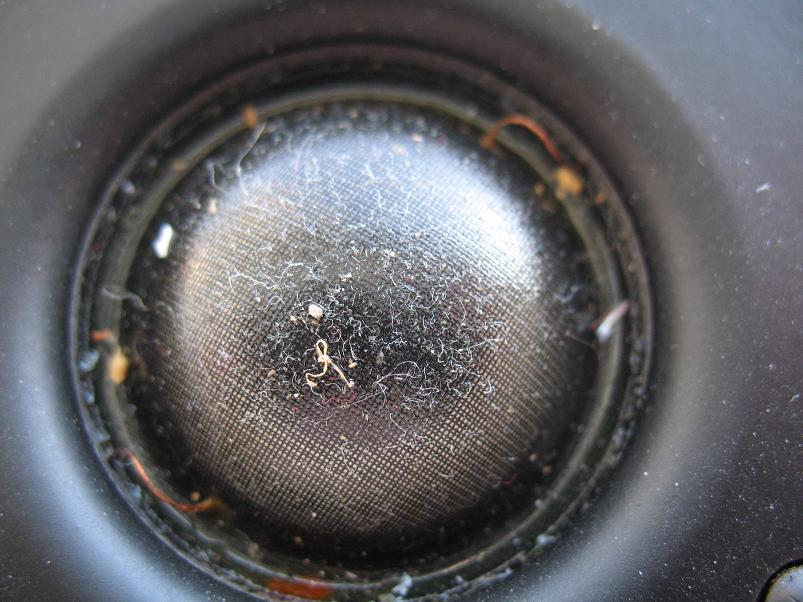

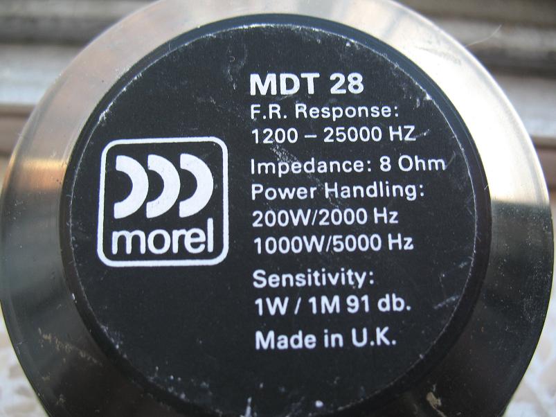

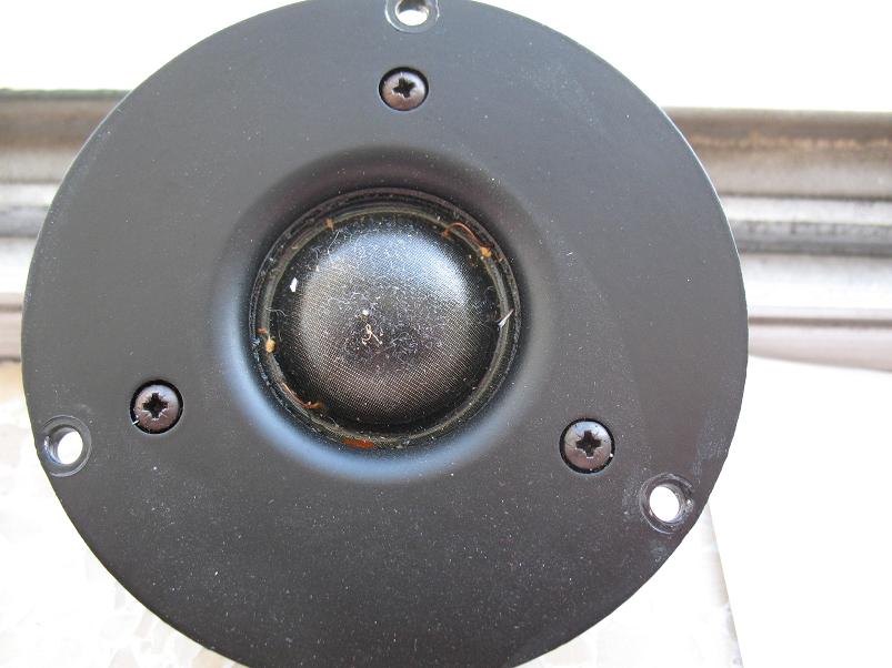

Hello
I have a pair UK made Morel tweeter , I would like to use them.
Actually they sound very nice.🙂 I chose them over the 9300 Scan Speak , to me the Morel sound better..
My problem with them they are a bit dirty.
Did someone ever try to clean sticky dome tweeters?
Any advise, I do not want to destroy them.😱
Please let me know if you have any idea.
Thank you !!
Greetings gabor

Hello
Nothing you guys advised worked out.
On the end I used Mineral Spirits , I washed done all that sticky stuff with a small painting brush. It took me a half an hour.
Now I put a thin coat of paint on it because there were a lot of small holes on the silk.
I did on one driver, I wait until will dry so I can do a listening test com pare to the orig.
I hate that sticky stuff!
I hope it work, now the dome got a bit lighter.
Thank for all your advise.

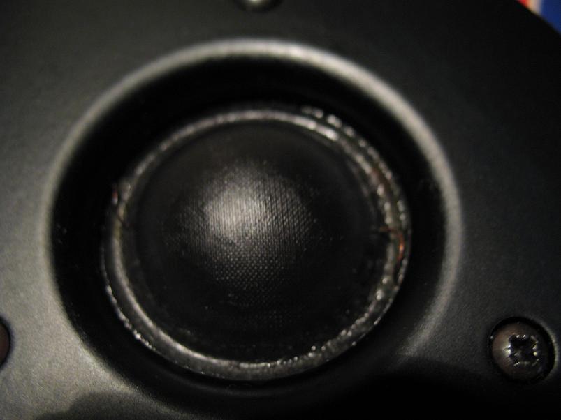

Hello
I made some picture from the driver, the paint didn't dry yet but I like the result.
No more dust etc problem.🙂
I will com pare with the orig sound wise, I hope at least as good as the orig.
I wait a day or so , so the paint get 100% dry.
The dome still nice and soft..
Greetings gabor
Greetings gabor

Hello
Yes I removed most of the stickiness from the dome.
To fill up those tiny holes between the silk I used thin black paint ,one coat . Now after the paint dried out it look even better.
I have to do some listening test.
The dome itself very soft, I hope the sound will be at least as good when it was dirty. I think now much lighter the dome itself.
I removed a lot of dust ,hair with the sticky stuff. What ever is that sticky stuff it so strong even with packaging tape I couldn't removed the dust. It took of the glue from the tape.
So I soaked in mineral spirits and after a while it came of. That sticky stuff is like a magnet to the dust!
It may sound good like that but I think is still not the best idea to use that .
Hard to protect against to the dust etc.
Greetings
