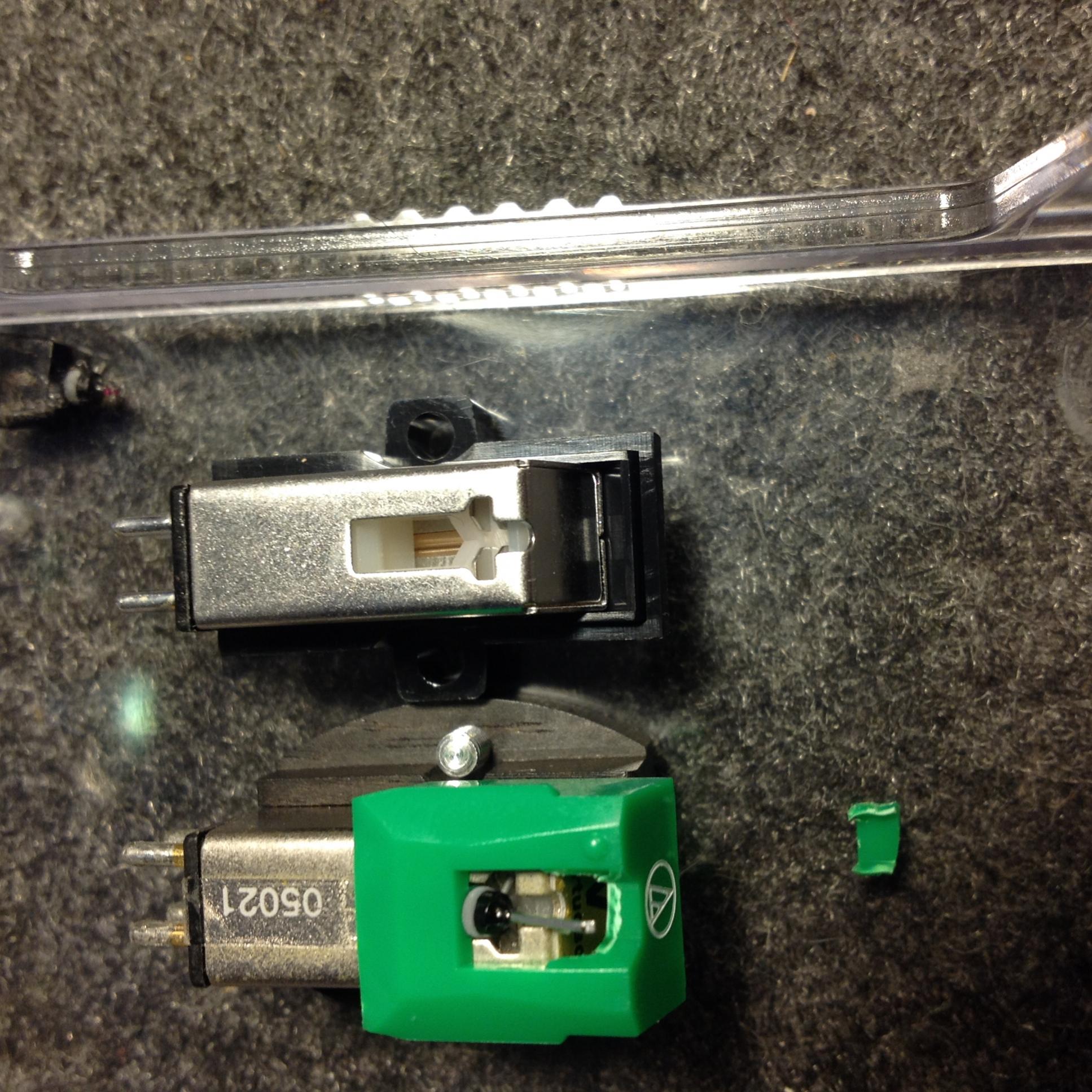

First of all removing the stylus... I don t know what they mean "not user serviceable", but if you catch the black plastic stylus with some pliers and pull it, it just comes off... that easy... I don t mean pulling it like a moron.. carefully so that the small magnets do not scratch the walls coming out... although I would not worry too much... it seems pretty easy and straightforward.
Now that we got it out, we need a replacement. As it seems, Audio Technica is the OEM for at least some of the parts of the cartridges, including the stylus. The magic part number is AT95e and costs about 30 euros from ebay. You need the replacement stylus, and not the entire cartridge
Now if you have already removed the clearaudio stylus, you have probably noticed that that thing is much bigger...
This is where the most minorlly tricky part is... we need to do some minor surgery to the AT95e.
If you compare the AT95e with the clearaudio, you can see that the AT95e is the clearaudio one with some more plastic attached to it. Basically you just have to get an exacto knife and cut the extra plastic right next to the needle carrier, so that you get a part that is identical to the clearaudio in size and shape. I don t have a photo, but if you look at it, it is pretty clear what you need to do...
You just need to take your time and do this patiently and you can get a pretty nice looking part. If you do it fast and sloppily it will still work (provided that you do not damage the needle suspension or the needle of course...), but it will look ugly...
And now that you have your brand new part, just push it gently in the cartridge body..
The thing fits so nicely that it will click in place, as if the parts were designed for each other... If you do it properly, you will have something like that...

Instead of cutting away most of the stylus' plastic carrier I just cut out that small piece in the front that prevents the carrier from clearing the front of the cartridge. This will allow me to use the stylus guard if needed. It took me about 5 minutes. Haven't mounted it yet so can't comment on its sonics. Thanks again for the mod.

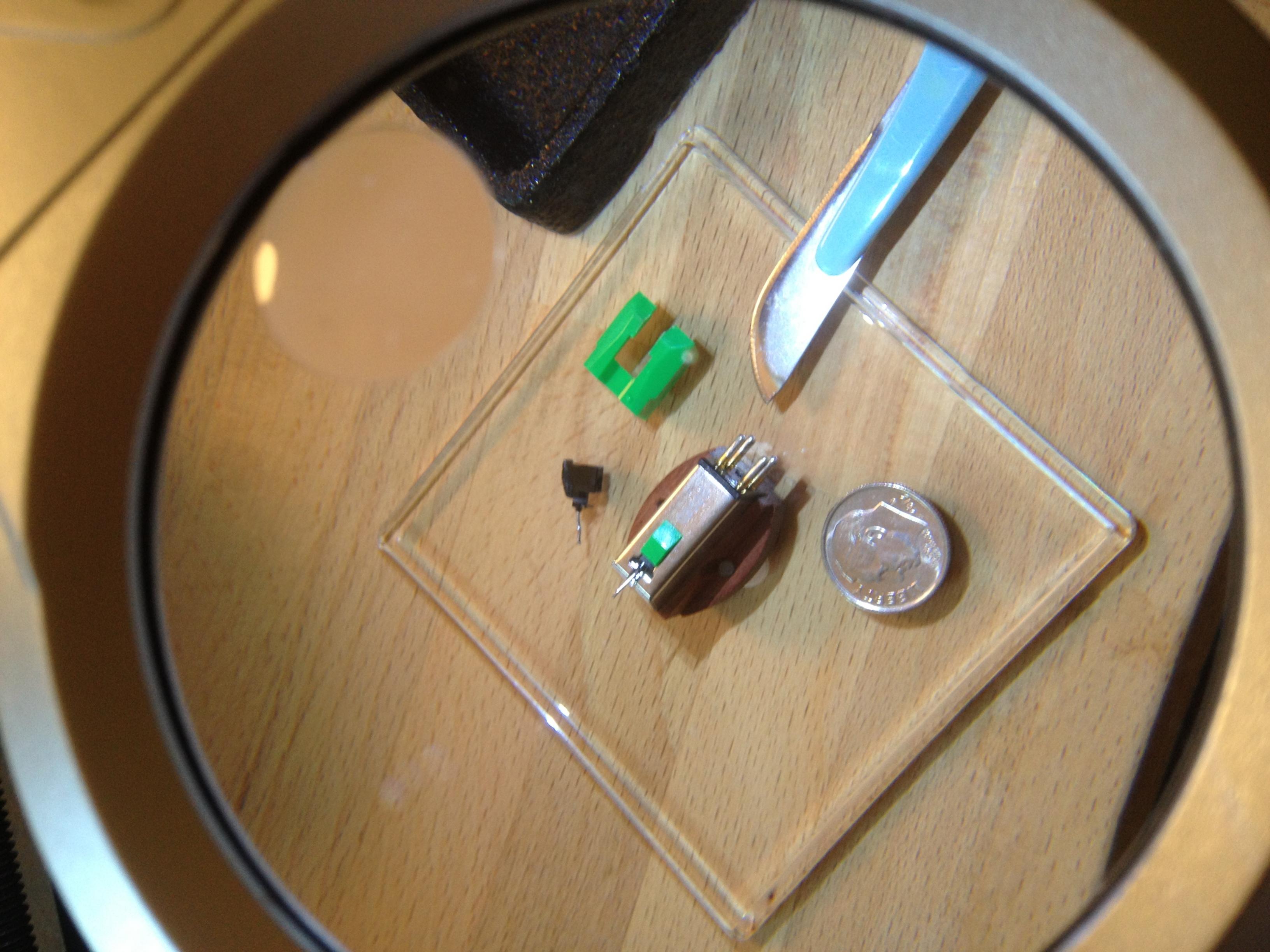

I've been really careful, alternating with a bit of cutting through pressure and a bit of sawing while keeping the stylus always protected in the transparent part. You have to be careful not to slip or damage the two small side metallic parts, better go slowly but even like that it didn't take me no more than 10 minutes. Though the small surgery doesn't look perfect it looks really neat when it's mounted. You could barely tell the difference, especially if it were painted in black (not even worth it).

Sorry for the poor quality pictures, i did quickly with the phone. But here they are together before the operation. They look really the same, apart from the plastic (green) part before cut. But this should have no impact in the sound. What does matter is the stylus obviously and the 2 small metallic side connectors. All the rest with the green plastic (same green in the original!) is only meant to hold the stylus in place in the pickup body and this fits really perfectly.
Original stylus part from the Alpha Aurum (with broken stylus!):
Now the part extracted from AT95, if the cut were perfect you could not tell the difference. But once mounted if you paint the bottom part in black they would look literally the same, no one could tell the difference!

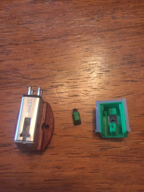

Can't thank you guys enough, so so happy to come across this thread! I was so sad to find my stylus broken in under a year of having the turntable, and thought I'd in for a hefty bill. Just swapped my CA Virtuoso stylus with the ATN95E (apparently replacement for AT95E) after cutting it out and inserting into cartridge...it looks identical but is green - fits like a glove and sounds identical - $54 CAD.
