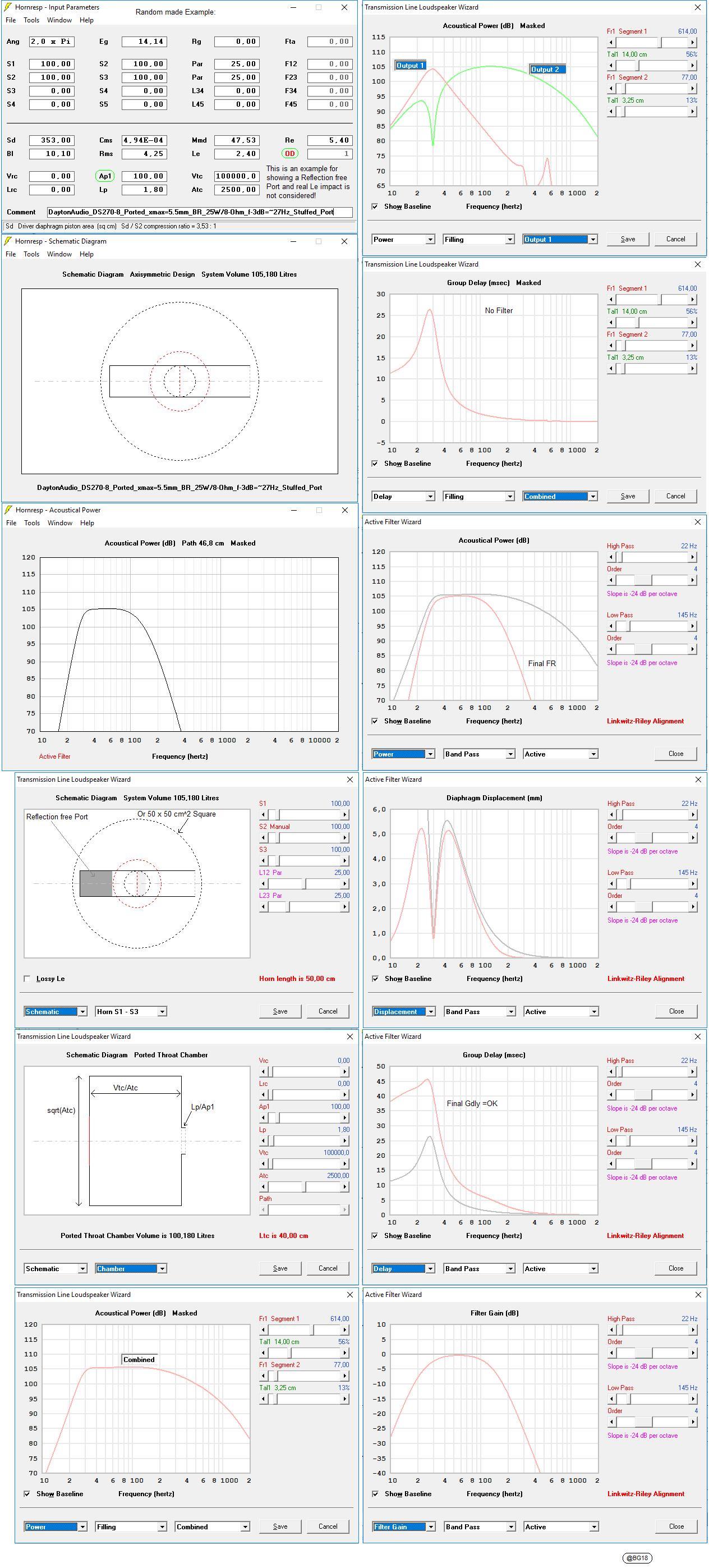

Including a "stub" at one end of the port (pipe) could reduce pipe resonances, Brian has shown how it can be modeled in Hornresp. The "stub" does not make "the system see a longer tube", it shortens the port length.
For most subs, the pipe resonances are much higher than the pass-band, so are of little concern.

There's another possible way to reduce the effect of pipe resonances without taking up additional space with an extension added to the start of the vent: design the box so the vent is half the length of the box and its internal entrance is as close to the center of the box as possible. I ran into this when retuning my "Enigma" 4th order BP subwoofer. I shortened the vents and noticed a dramatic drop in the pipe resonances, to the point that the subwoofer can now be used without any low-pass filtering in place. See the before and after FR curves attached.
