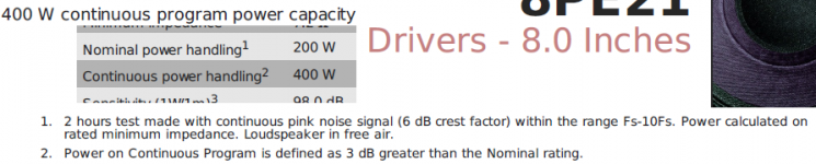

I think you missed to spot this from the manufacturer:
I stated from the beginning that I read data sheet. I know the power of 400 W is specified for 6.3 ohm impedance minimum, but that powermixer can provide 444w in the impedance at 0.1% distortion. Do not say anywhere that overcoming that power of 400 W to 6.3 ohms for 10 seconds, can lead to irreversible destruction of the speaker. And please note that I heard a commercial song, not sinusoidal.
I am no expert on this sort of power handling problem, but IIRC, the thing that destroys a voicecoil is heat, which depends on average power.
B&C quote 400W with 6dB crest pink noise long term.
That pans out as follows:
Average 100W
Programme 200W
Peak 400W (6db Crest Pink Noise)
Speaker power handling < Pro-Audio References
Seems to me that rap material might have been very energetic, and very compressed. 100W of heat is what the speaker can dissipate long term. About equivalent to a bright old filament lightbulb. Hope it helps.

3.b. (Scaled by me for your driver) Programme power. It is an archaic term that derives from old swept sinewave power tests. Nowadays, it does hold no real meaning. For most manufacturers, it is simply twice the average power, although other manufacturers may use ratios other than 2:1. It may be used as a guideline to the selection of amplifier power. For instance, a speaker with 100W average power and 200W programme power (2x100W) might use an amplifier with 200W output. This is for carefully controlled conditions; for more usual applications with some degree of abuse that amplifier would be too large.

It seems the what B&C call "nominal" (6db Crest Pink noise) is what other people call peak! 🙁

400W at 43Hz (the low note in the linked song) is pushing that driver really close to it's rated Xmax. Therefore the power handling is probably already starting to diminish at that frequency.
If you read the fine print of the manufacturers datasheet they state that the continuous power is rated for pink noise Fs to 10*Fs. That signal will not generate anywhere near as much excursion as a continuous 43Hz bass note.

Bass excursion could be a factor, but the smoking gun here is surely that the RMS rating is actually 100W not 400W. 😀

Speaker power handling < Pro-Audio References3.c. Peak power. Corresponds to the calculation of power based upon peak voltages. For a 6 dB crest factor signal, peak power is four times the average power.
