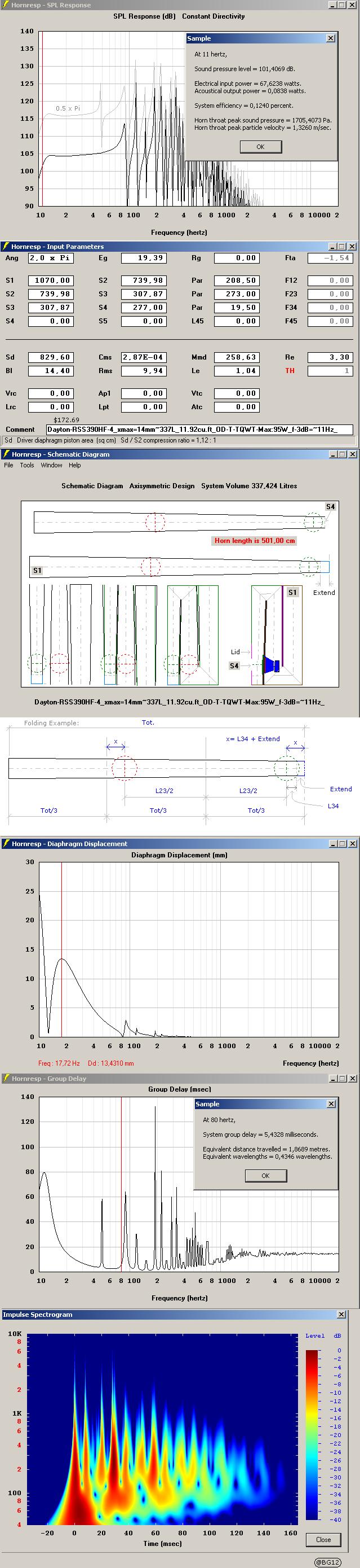

Hi mikee,
Here is a suggestion of a sub using the Dayton Audio RSS390HF-4 driver in a folded T-TQWT:
b🙂

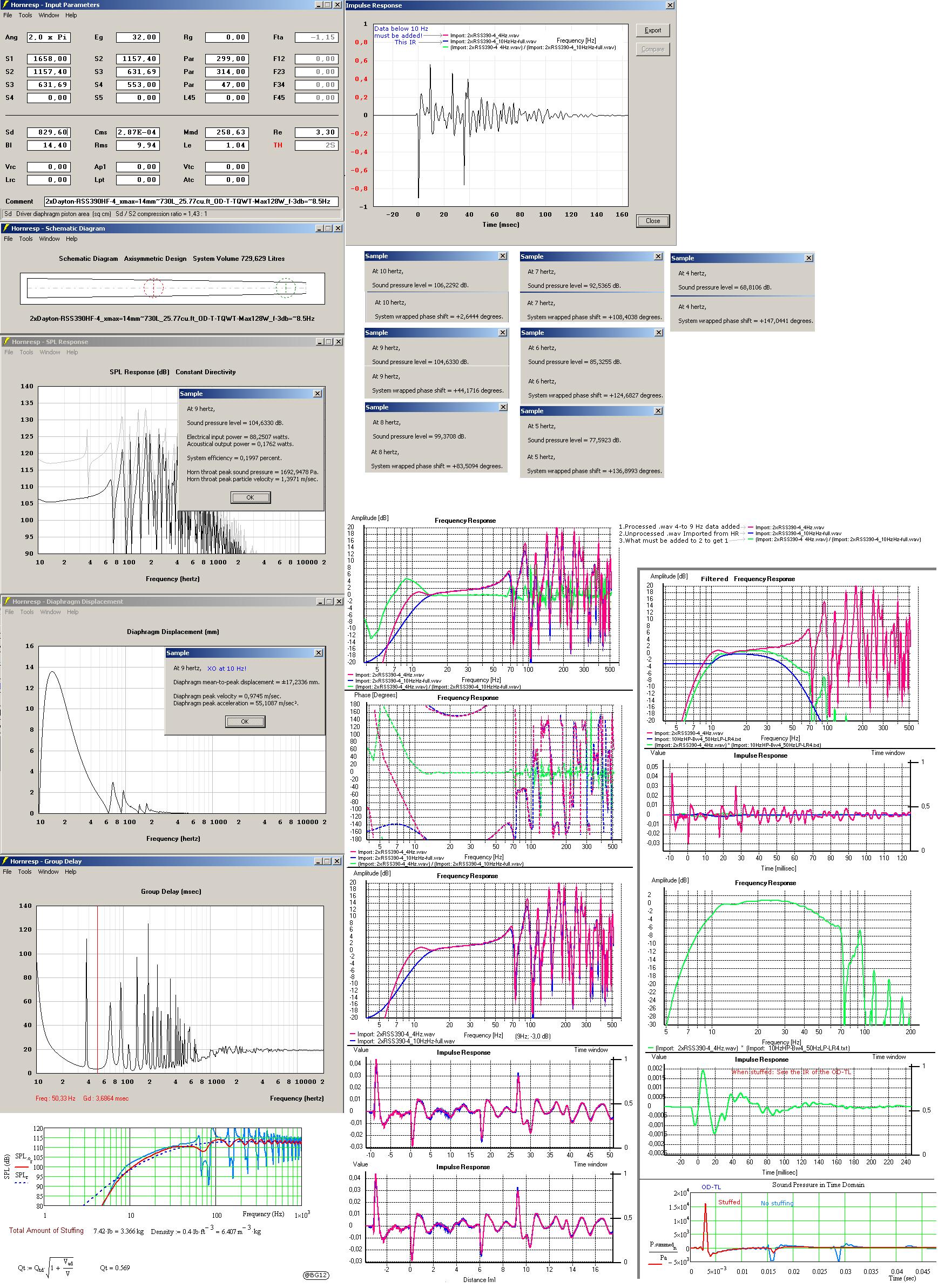

Hi mikee,
b🙂
FYI: Here is another one using two drivers:
b🙂
