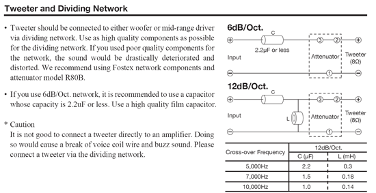

These instructions for the Fostex FT17H Horn Super Tweeter will give you some pointers.

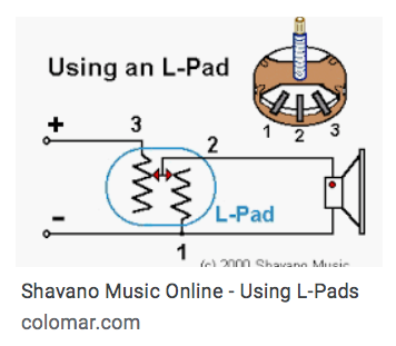

Here's some information regarding the L pad attenuator wiring.
The three terminals on the L pad are numbered 1, 2 and 3 as shown in the diagram, so you can't really go wrong:

There is nothing wrong with wanting to experiment with a super tweeter. I've done it - probably millions have done it! 😎
Just a quick note regarding the above diagram - which is correct >
You can't just simply connect the L-pad directly to the Pioneer box input connections. A filter has to precede the L-pad.

Although they are 4ohm tweeters, if connected to an L-pad, around 'midway dial setting', they become more around 6ohms.
They come with a single capacitor as a crossover, but should actually be driven by a capacitor PLUS a coil > being second order/12dB per octave filter.

Yes, in addition to the driver the necessary crossover must be provided. Arent't ribbons and AMTs more 'straight' in the impedance trace? So it would help in calculating the crossover. I had 0.33 uF and 0.3 mH on hand and it worked for the mini-8. For the 4Ω with the pod values change. A choice of values would still be recommended. 0.33 -0.68 -1 -1.5 uF caps
and 0.1-0.3 (200 uH) coils. But who knows...m
