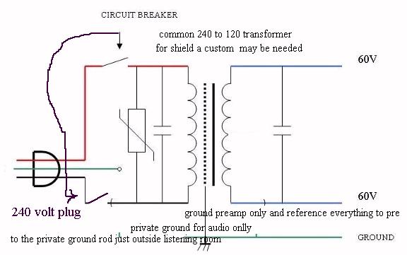

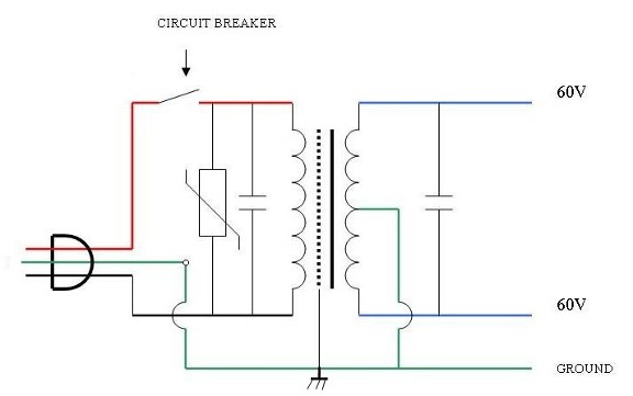

Have actually used that one I posted in a recording studio and a scientific lab. One used an off the shelf 240 to 120 transformer and the other was a custom one for the lab. The lab one also got a series LC circuit to force the wave into a sine.
Sumaudioguy,
Question about post#6 – why did you mark secondary windings 60V?

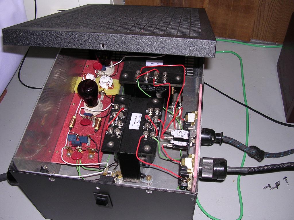

I have actually made one with technical ground etc. I modified Jon Rish’ schematic for my needs. I remember Jon had a long reliability disclaimer on his site, therefore I am showing only a picture.
I also tried the Power Plant 300 - it was running hot even when switched off – a total waste of energy. If I were younger I would take my dedicated room off the grid.
Marek
<snip>
That is some sloppy drawing there ehy? Wrong is wrong- it should be 0 and 120 volts.
