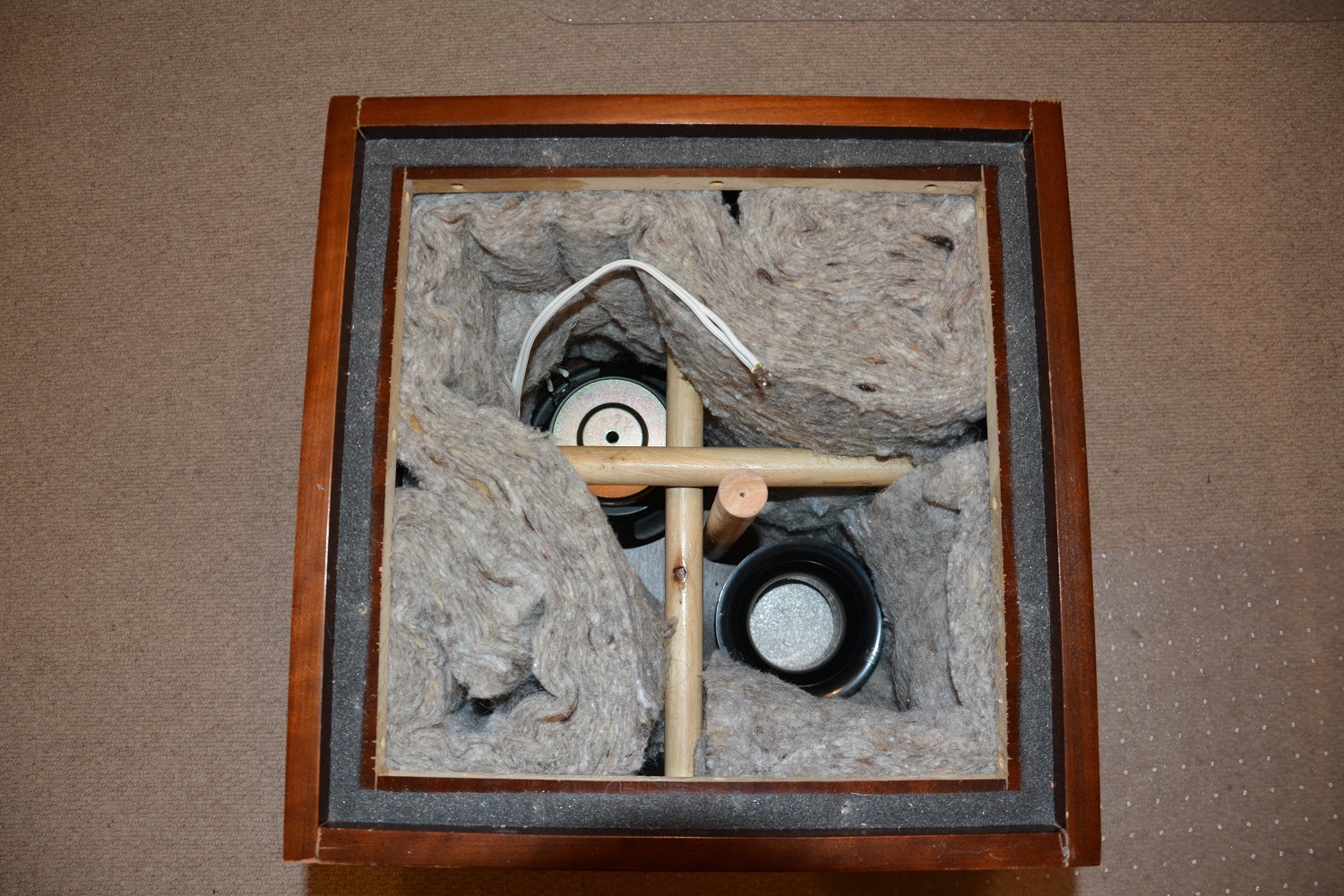

Alrighty then.
I've got some photos of the cabinets, below, and I've managed to get some measurements by unscrewing one of the screws in the handles a bit, and then clamping the pickup to the screw.
Looking up into the cabinet:
Through the bass driver cutout:
It looks like there's a cursory attempt at bracing in there, but this also forms the bottom shelf of the two slot ports.
Looking into the access panel:
Clamping to the handle:
I got lots of very ugly-looking graphs out. Usefully, it looks like one of the biggest feedback problems (191Hz) is definitely a panel resonance. There's also a lot of stuff going on up to about 600Hz.
How would you guys like the data to be presented?
I've about 10 graphs, each one taken at a different point on the handle, or summations of two pickups in different places.
So far, I'm thinking of 2 cross-braces towards the bottom end, and one underneath the horn but well above the bass driver.
Chris

Interesting that the resonances are up so high. That may be hard to deal with by bracing. But it's worth a try!
Be sure you know the exact location of your pickup, for repeatability. I still think big round dowel (what is often called Closet Pole) is the way to go. Do you need one, or three? Hard to say. But you are armed with the methods to find out.
On my big Altec boxes I had to brace, thicken the walls and use bitumen mixed with sand on some parts. A royal pain, but it worked wonders.

The pickup locations are just the screws holding the handles in - plenty of repeatability there 😉
I have two of these cabinets, so I'm going to get some dowel and take measurements after adding each one, with comparison to the original.
I'm also wondering if I could add a front-to-back brace, for additional baffle support. I'd probably just extend the half-a-shelf back with a single dowel and call it good - anything is better than nothing at all.
Anyway, without further ado, here's some spectacularly nasty looking graphs. The datapoints are offset against each other for clarity, and I'll talk through each one in a moment.
First, though - the handle has 10 screws, 3 along the short edges, 4 along the long ones.
Top middle = top of the handle, middle screw
Bottom front = bottom of handle, nearest the baffle.
First up, bottom of handle, blue is front, pink is back.
Front of handle, blue is bottom, green is top.
Lastly, middle of handle, pink is top, and the icky green-blue is bottom.
So, things to note:
- the 200Hz is pretty well everywhere, as is the 430Hz.
- the 270Hz peak only occurs in some measurements, so only careful placement will get shut of that.
- the pink/blue trace looks like its gonna have another peak around 800Hz.
- its amazing these sound anything like as good as they do.
- I suspect the 200Hz resonance will disappear if I brace pretty well anywhere, since it appears in all measurements.
Next steps:
- draw up a map of where bracing would be most effective, noting the 270Hz in particular.
- get hold of some dowel, min 1" diameter, and add it to the cabinets according to the previous step.
- lots more measurements.
- line the cabinets with some felt, mostly to kill reflections coming back through the LF cone.
