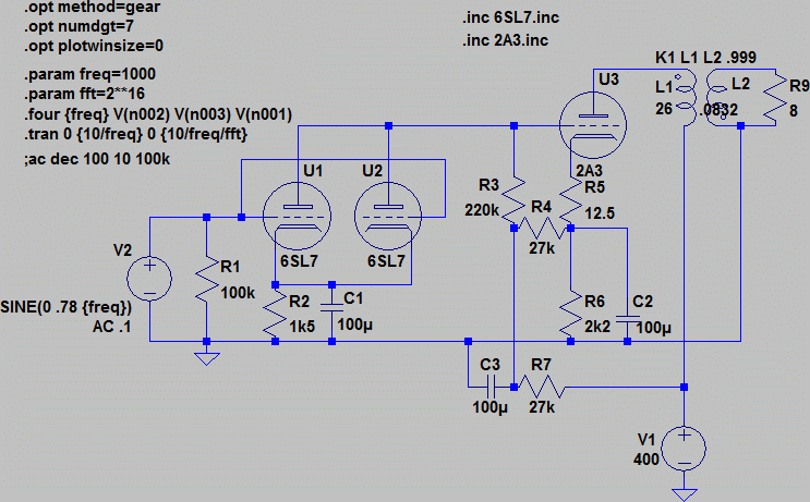

Just Finished Morrison Micro 2a3 . Has anyone idea how should this be biased correctly ? Mine has B+ about 420volts . With schematic given resistor values 6sl7 paralled has 195v on plate and about -25 on 2a3 185 volts over tube ,about 220 volts on 2a3 cathodes .So quite heavy currents about 90ma ?? Is this Correct ? Thanks for Info

You adjust the cathode resistor on the input stage and/or adjust the cathode resistor on the output stage.

Cathode resistor on input 220 ohm ( then I got -37 on 2a3 ) maybe it must nearly ground to achieve desired -45 ? . Or liftin up to 3300 ohm on 2a3 ´cathode I achieve same -37 but I got then about 210 volts over 2a3 ??

paralleled hi mu triodes will have huge miller cap. 404pF
i dislike whole schematic, second reason: big distortion and gain will be small here.

2A3 Miller is high enough, to interfere with low gm, hi mu driver (less treble gain&more thd)
Reason why i have FET mu follower instead..😉

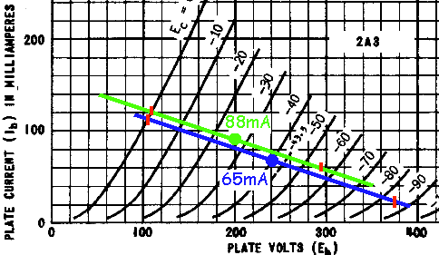

> Where did the -45V figure come from?
It's on the datasheet.... for a significantly different B+ and load. Of course we should expect different bias for different conditions.
> -45 60ma 250v over tube should be ideal for 2a3
For 2.5K load! (Not 3k.) And for Selling The Tube, not for seducing Golden Ears. In fact the condition is fudged to give exactly 5% THD, which was "accepted" at the time. Look at page 3 of Tung-Sol 2A3. A wide range of loads gives a lesser range of Watts and THD. (Conversely, for given load, a wide range of current is possible with lesser range of Watts and THD.)
"-45V bias" is a Serving Suggestion, for when you don't know how to use it. Like the cake-mix box tells you to add 2 eggs. The cake will be OK. You may like it better with 3 eggs or no eggs.

1) On many amps, too cool does not make "all" output power expected; while too hot burns-up the tube. But in this odd design the 2A3 can NOT idle over 16 Watts! (Assuming 400V supply and 2.5K cathode R. At 420V 17.7W is possible.) As 16W ~~= 15 Watt rating, you can not seriously cook the tube. That worst-case happens when cathode is half of B+. Go off that point *either* way, Pdiss drops.
2) For best power, approximate Tube + Load as 800 + 3,000 or 3,800 Ohms. Now figure voltage to make ~~15W in 3,800r. 239 Volts. Take that away from 400V supply, 161V on cathode. Check: 161V across 2,500r Rk is 64.4mA. 64+ma at 239V is 15 Watts.
A plot on the 2A3 curves suggests that 239V 65mA gives much wider swing and a couple dB more power output, with some rise in THD.
Your 220V instead of 161V at cathode seems high?
But wait. Taking my 239V 65mA with 161V at cathode, the grid must be swing down 86V or to 75V. Will the 2x6SL7 driver with 47K to ~~300V pull-down that far? Squinting the 6SN7 curves, I do not think it will. So where the 200V 88mA bias clips at high currents, the 239V 65mA bias clips (in the driver) at low current.
Ah, what to do?
When in doubt, try splitting the difference. 220V across tube and 76mA through it. Cathode voltage about 190V. Get there by diddling the 6SL7's cathode resistor. I would not worry over-much about what G-K bias it ends up at.
But consider also. We have two triodes both working near the limits they can swing. Large current variation, thus significant 2nd Harmonic Distortion. The 2A3 alone will approach 5%. The 6SL7 will be similar, but *opposite* phase. The two 2nd harmonic curves will tend to cancel. The combined 2nd Harm may be far less than 5% near full output. However "minor" harmonics begin to stand out. The exact "best sound" biasing would need brain-busting computation or tedious testing. And may be subject to personal opinion.
_I_ would start going closer to 70mA-80mA just cuz 2A3 is a costly tube and I want much of the Power I paid for. If my ears were better, and my listening levels lower, some other bias might be sweeter.
