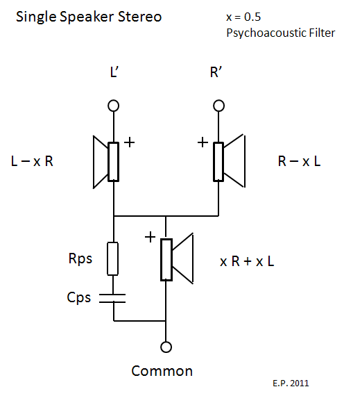

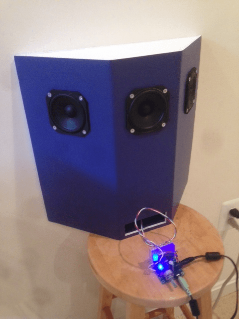

Actually, I set two small Karlsonators angled to the side and a central Karlsonator in the middle to test it out before I made a purpose built cabinet - all in foam core of course.
I made mine with 3x TC9FD’s in a ported reflex box with a trapezoid cross section. I used a class AB lunch money chip amp (TDA7298) which allows mixing three channels.
Wired like this:
https://www.diyaudio.com/community/threads/stereophonic-sound-from-a-single-loudspeaker.200040/
https://www.diyaudio.com/community/...matrixed-single-stereo-speakers.257110/page-3
http://elias.altervista.org/html/SingleSpeakerStereo.html
Wired like this:
Do you recall your impressions of it? Was it worth the hassle of mixing the channels compared to something like your flat wall mounted MLTL using the same TC9FD?I made mine with 3x TC9FD’s in a ported reflex box with a trapezoid cross section. I used a class AB lunch money chip amp (TDA7298) which allows mixing three channels.
