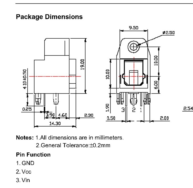

the philips mainboard has the possibility to add a toslink transmitter. I asked if someone had just done that mod.
In the cd maninboard there is a place to add the transmitter with 4 pins .I 've found transmitter with 3 pins ( GND, Vcc, Vin)

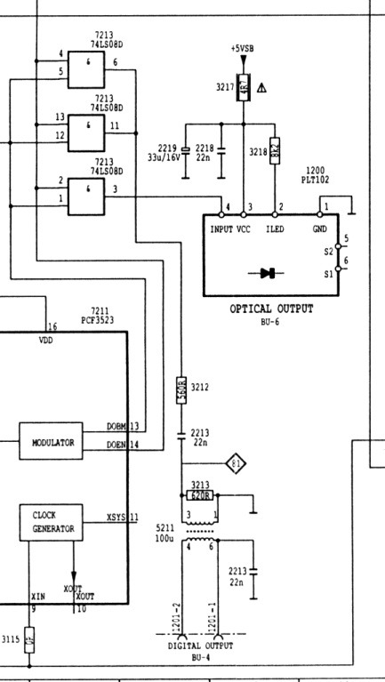

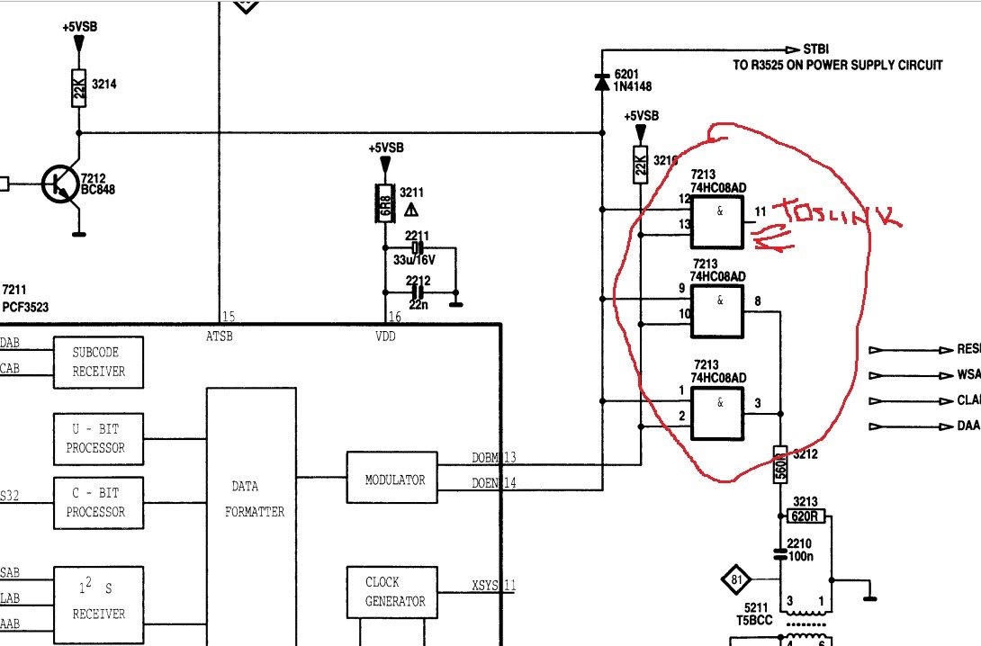

I've searched the philips Cd950 scheme as it has the toslink transmitter. The Cd930 and Cd950 has a similar gate microchip for the digital signal output.
This is the CD950 scheme :
This is the CD930 scheme:
As you can see there is the pin for the toslink output. it is necessary to add some capacitors and resistance .

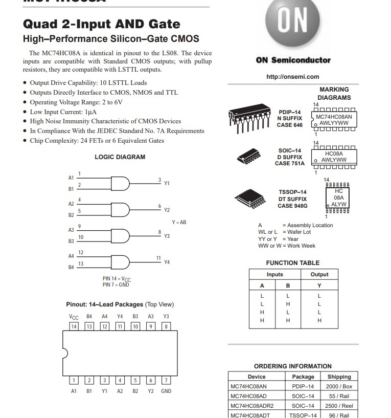

This is the gate chip specs:
This is the toslink transmitter pinout; as you can see this have only three pin and I don't understand how to manage the pin 3 on philips CD930 mainboard.
