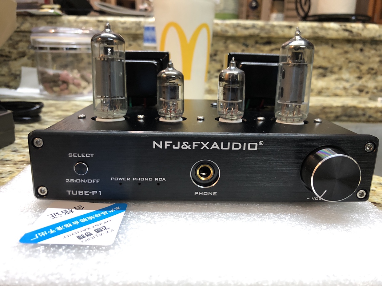

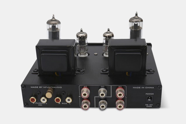

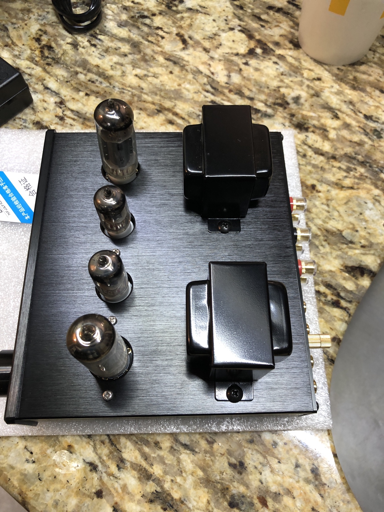

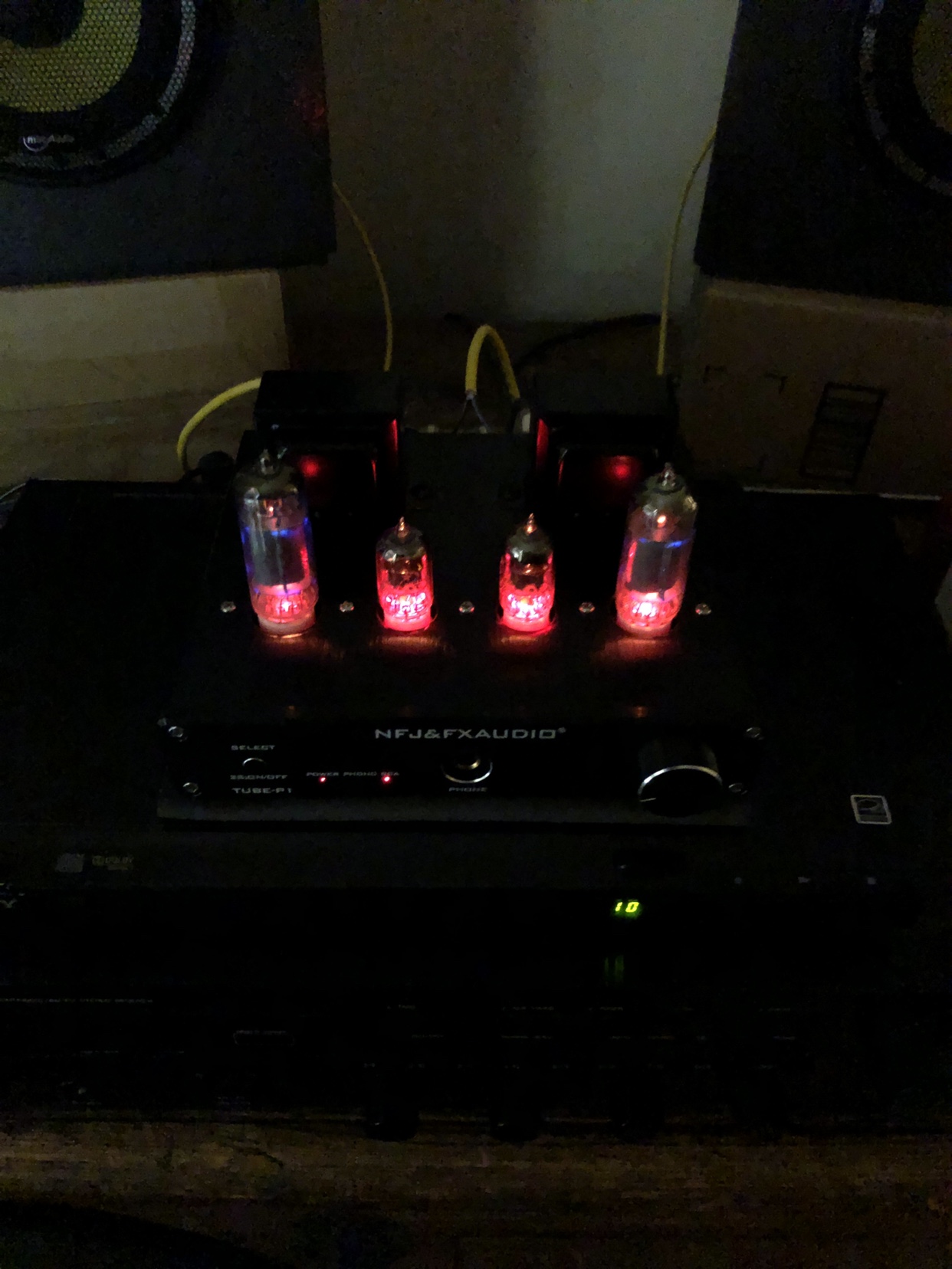

Hi guys I have one of these pre made tube amps with a cd and a phono input. It’s only 2.5 watts and is pretty small Things I’d like to change is this Add some type of tone or eq controls Add a preamp outputs so I can use it as a preamp or add output/ input rca’s so I use a eq with it Here’s from photos of it and I’ll try to remove the cover for pics of the inside And for power it has a wallwort power supply
Your parade has been rained on, sorry. The wherewithall to do what you want is not present.
Truly good tone controls are complicated. You are not going to be able to add 4 tubes to that unit. A tube/FET hybrid variation on that theme still needs 2 additional "bottles".
My guess for the tube complement of the unit in question is a 12AX7 and a 6BM8, in each channel, with the 'X7 being a phono preamp. The 'X7 triode has very poor load driving ability and will misbehave if connected to low I/P impedance SS device, like an equalizer.
The best suggestion I can come up with is to use the headphone O/P to drive an equalizer and have the equalizer drive a separate power amp.

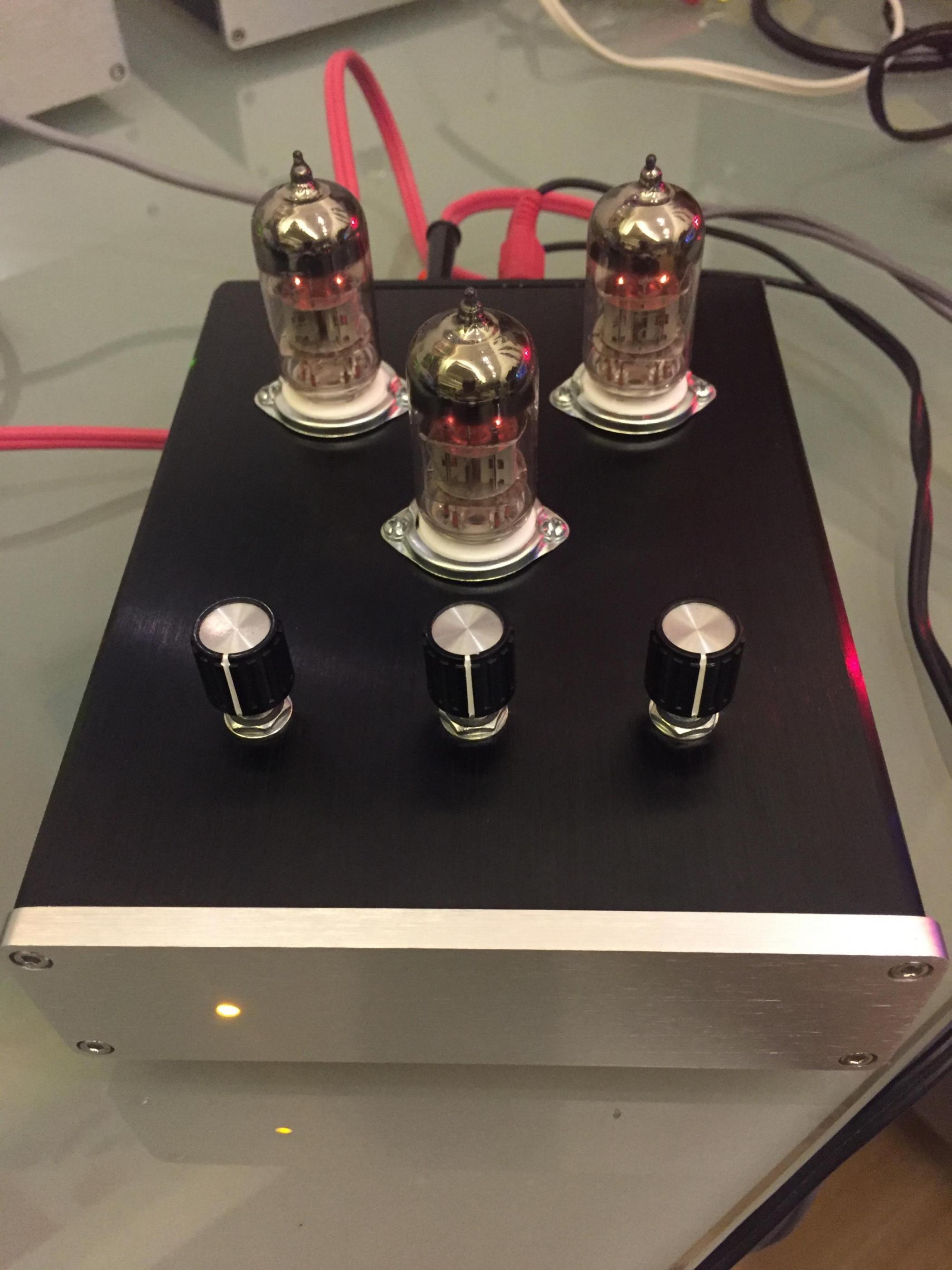

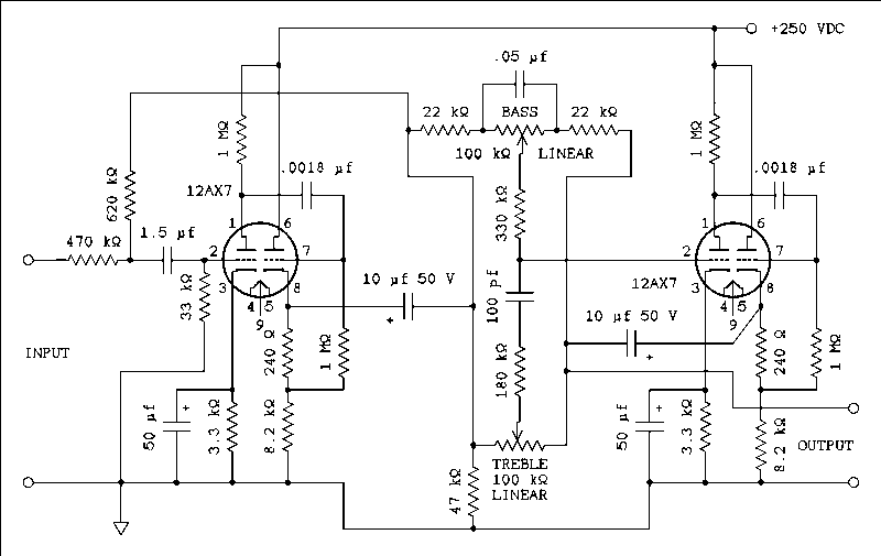

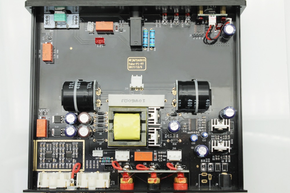

Here how look like inside your amp, if I have this amp I will never ever try to made any modification to the original design. How you can see lots of solid state component, a dc-dc boost converter also the phono riaa pre-amp is solid state one, so the warmth of a pure tube amp is compromised and even the volume pot look quite accessible still could be difficult add any circuit to it, the only thing you can do is add and external tone control between the source and the rca input, can be a solid state one or a tube based one, I already made some of them and one in particular 3 tone control work like a charm, here picture of it, you can find schematics and suggestion in this website Practical Tone Controls.

I'm too busy to build outboard tone controls right now, so bought one of these and it is very quiet, has plenty of boost/cut, is very small, and wasn't that expensive, especially in comparison to my preamp and amp. Definitely pleased with the unit.
