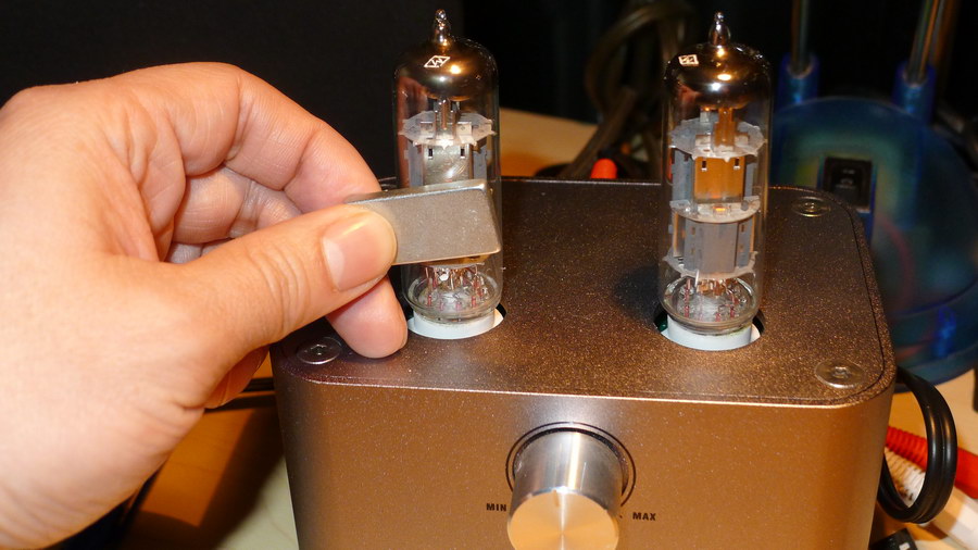

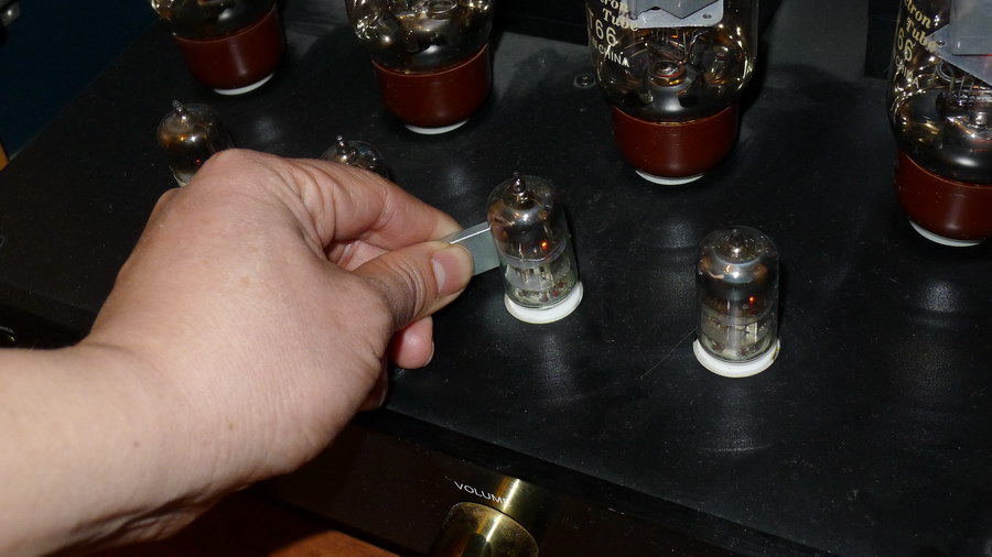

Today we receive a lot of thulium magnetic for a researching project (they are super strong magnetic!). The EL-34 PP amp came into my eyes when we were discussing about the project. A strange idea came into my brain suddenly: the magentic can affect the moving path of electron, and the tube is working based on electron emitting and moving, so how will the magnetic affect the tube amplifiers?
I decided to give a try. I have 3 tube amplifiers in the office: a EL34 PP amp, a 12ax7+6N1 tube headphone amp and a 6F3 3W small SE amp. After power on them for a few minutes, I put a magnetic close to the tubes and wave it. There's nothing happen when wave near EL34. But when put the magnetic close to the preamp tube 6N2 of EL34 PP, clear "pop" sound can be heard in the speaker. Then I tried with headphone amp and 6F3, both have clear "pop" sound when wave the magnatic near the preamp tube. But no clear sound can be heard at the power side.
I don't have time to listen how it affect the sound quality. And I don't have golden ears to distinguish the differences. But I think it's a interesting test, gurus with golden ears can try to listen to the sound quality affected by the magnetic, maybe there'll be some amazing result😛

Moving a magnet near the tube will induce a small voltage (Faraday's Law). A static magnet, unless it's ridiculously powerful, will have close to zero effect on the tube's operation.

What are the grid wires made of? If they're magnetic a strong magnet could move them, possibly causing them to touch the cathode. That would cause an audible "pop".
I believe the audiable pop is not caused by the reason you mentioned. if grid and cathod are short, it won't be slight pop, maybe bomb
A static magnetic field will bend a beam of electrons - that is how a TV CRT works. It won't make much difference to a triode, because all the electrons end up at the anode eventually.

The pathlength of the electrons is on the order of millimeters. Spacing between the electron stream and the magnet is on the order of a centimeter. The potential between cathode and anode is on the order of 200V. So you can readily calculate the velocity of the electrons, the strength of the field, and consequently the deflection of the electrons.
Or you can stick a magnet near a tube and see that it doesn't really do anything.
