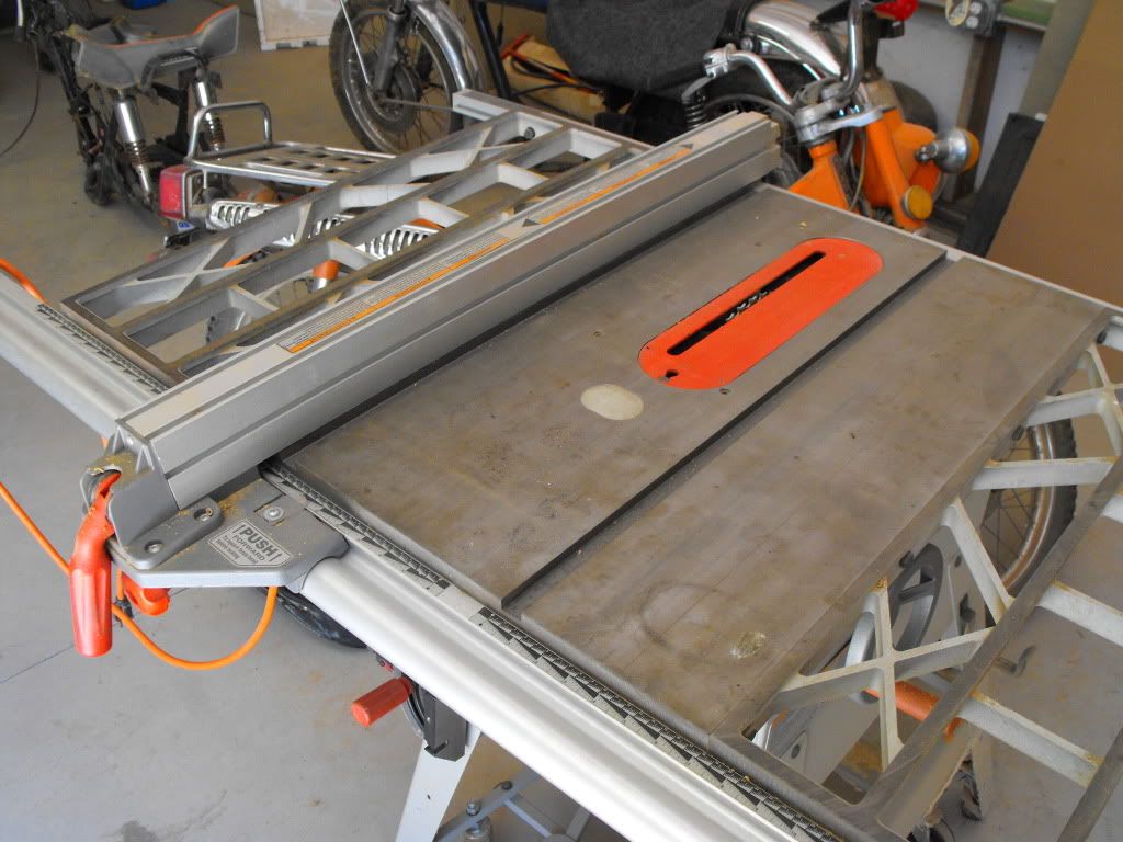

I have built probably more than 10 boxes, all car audio. They either get rattle canned or covered in carpet. The straightness of my cuts has always bothered me but never been a problem, until now.
Now I am cutting up wood that is alot more expensive AND in the end all the edges will be seen. They need to be perfect. How are you guys doing this!? I have a table saw with a fence but everytime I clamp the fence down it moves and my cuts end up crooked. Every time I want to cut I spend too long measuring the fence position and still end up with crooked cuts, even when I think I've measured well enough to make up for the fence. There really is no good way to measure fence position against the blade that I've found
The last few boxes that I've built, the only thing I use is the hand held skill saw. The only other thing I can think of to do is use my skill saw then sand the edges down to straight.
IS THERE A BETTER WAY? or do I just need to get a more expensive table saw and fence?
Here is my saw...

First be sure the table is level.
To check the fence, take a 24" wide board 36" long. Set the fence to 2" use extra clamps to hold it, and keep cutting the board until there is 4" left. If it is 4" at one end and something else at the other end then the fence is not parallel to the blade. Take the error divide it by the number of cuts and adjust the fence by 2/3 of that amount. Then do it again.
If the cuts are curved it means the set on the blade is wrong. That may also cause the fence to move. Get a new one and not a cheapie!
Finally cut the edges slightly over and trim with a router or belt sander.
BTY there should be a nut at the back of the fence that adjusts clamping pressure!

Impossible to tell just by looking at, but modify it such that the clamp does not
move. One option might be to spray the clamp rails with a textured paint or
car body undersealer, or similar. Or work out how to improve clamping, a
guide that moves simply isn't a guide, perhaps just roughen the rails and
/or the clamps, perhaps rubber sheet glued to the clamps, etc.....

it's your fence and rail clamping, mess around or upgrade to Biesemeyer fence system

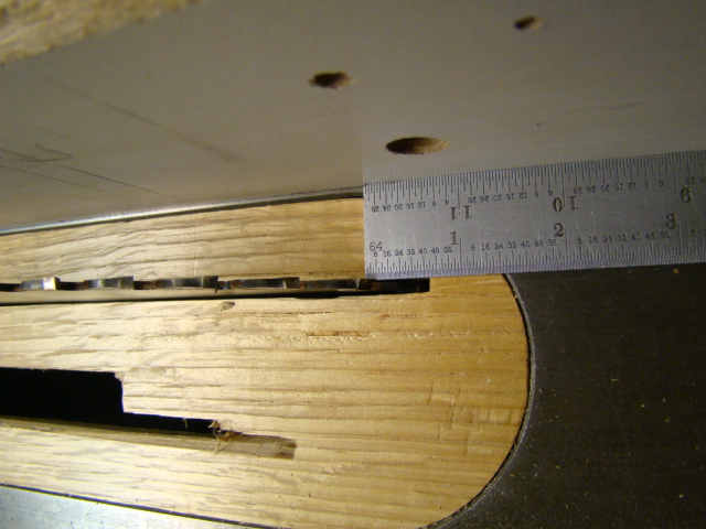

The fence and blade must be parallel. With the blade all the way up I use my ruler flat on the table and check the same tooth in front and back. Adjust as necessary.

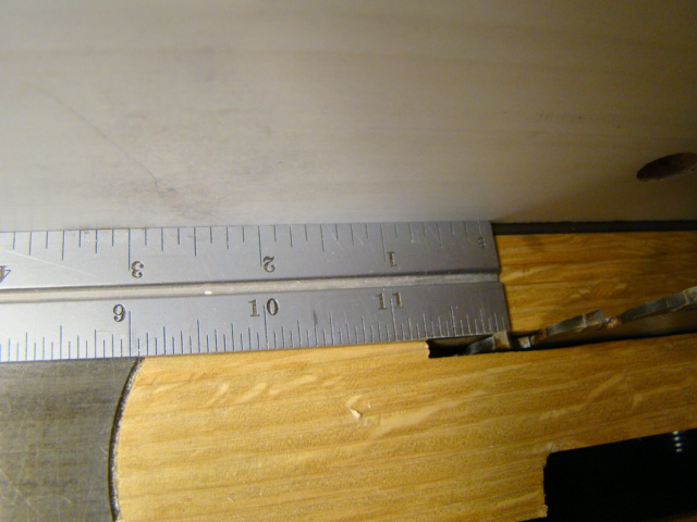

Hello Toy. With the saw UNPLUGED. Raise the blade all the way. Pick a tooth on the blade that rakes (points toward) the fence, mark it with a sharpie. Position the marked tooth a little above the table at the feed. Measure from the fence to the outer most tip of the marked tooth. Now rotate the marked tooth 180 degrees to the out feed. Measure. If the measurements are not equal either the fence is not square or the blade is not parallel. The adjustments will be covered in your user manual. I use this trick often, things come loose dirt or chips get into adjustments ect. Hint: the miter track is home, the point of reference from which you measure square and parallel. When you master this a veil will be lifted, no more over cutting or routing and little sanding. Good luck let us know how you do. Howie

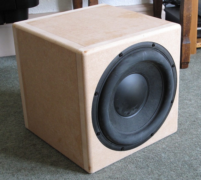

I almost exclusively use a router + straight edge for making all of my cuts simply because it gets the job done well. Might take a while to set up, but once you're set up you know that you're cut is going to be right.
If the cuts you're making aren't that big then you can use one of these.
Set the distance correctly then you don't even need to measure and clamp a straight edge. For this kind of thing, with a rectangular box, 4 of the 6 sides would all be exactly the same depth.
I cut all the MDF for 4 of these, using the above method in 1 afternoon.
You can see that the top and the sides are all the same width, but they are different lengths. In this case I set the router jig thingy to the right size (25cm I believe) then I cut 25cm wide strips off 4*2 foot sheets of MDF so I ended up with enough 25cm * 2 foot strips to make the top, bottom and sides of the 4 enclosures. I then repeated the process, chopping identical lengths off of the 25cm * 2 foot strips, until I had all the MDF cut for the top and the sides of the 4 boxes. Using this method I didn't need to measure anything except the initial cut made with the jig, then one measurement each for the different lengths for the top and the sides. This in part is like using the table saw, you set the fence distance then keep chopping away until you've got enough 25cm * 2 foots etc for your cabinet. As explained this can be done with a router and if you don't have any luck with your table saw and you've got a router, you could swap to that. Every router I've bought has come with a free jig as shown above, so if you've got a router you might already have one of those.

I'd be surprised if the stock fence on any saw with a cast iron table didn't have a lock-down force adjustment on it somewhere.
That table looks a bit corroded. One time I had to go over mine with a wire wheel in an angle grinder because I left the window open in the garage before a rain. Once in a while I hit it with some steel wool and always try to keep some wax on it. Makes it so more of your positioning/feed force doesn't get caught up on the table. Yours looks like it's ready for the wire wheel.
There's a good chance that the fence needs a complete setup.

Does that fence only clamp at one side. I don't have a saw like this, but does it move a the other end as it's pivoting on the end with the clamp when you push wood up against it? Could you try also clamp the other end manually with another normal clamp?
