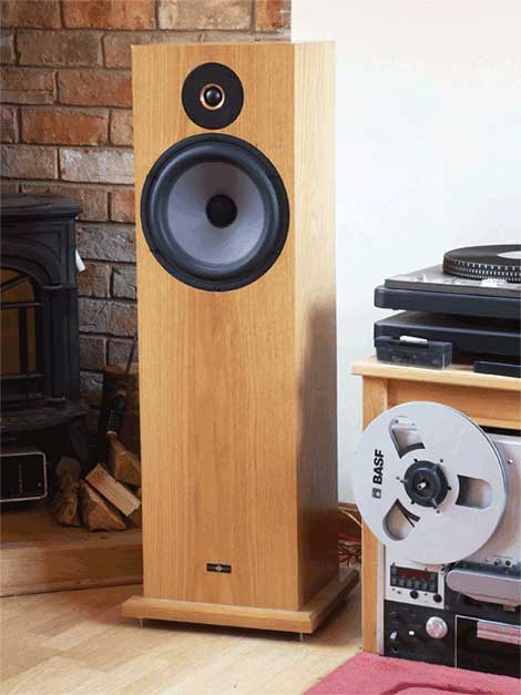

For those unfamiliar with the World Design 25T EX, I attach an image.

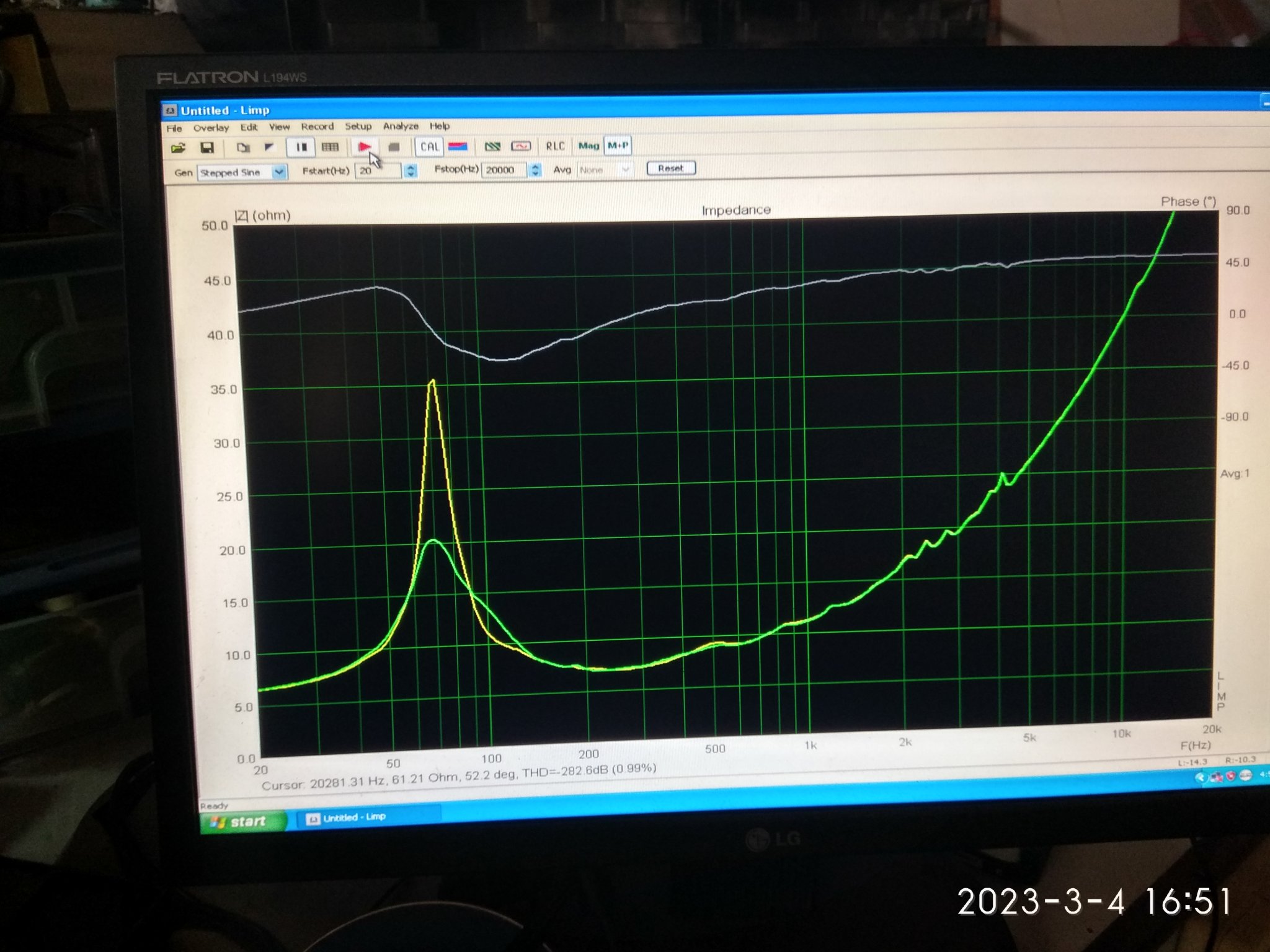

Can someone explain me,when I use Arta limp for woofer in cabinet impedance measurement.(for ideal damping finding).
First,woofer only,no crossover what is the gol,what I need to look for?
Second,woofer+ crossover,what I need to look for?
Do we looking for the min impedance, adding more damping material?

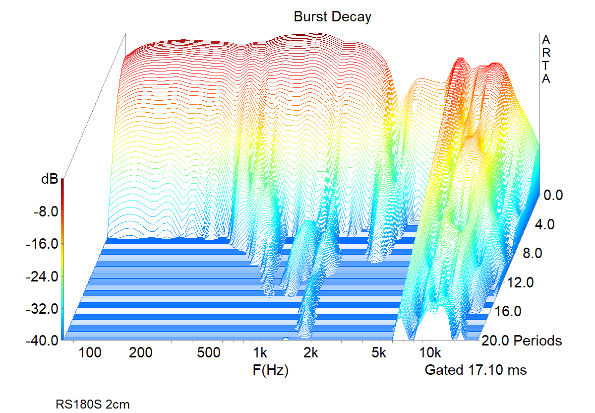

I'd say: measure impedance open air and make note of all irregularities (spikes). Then mount the unit, measure again. You'll probably notice some irregularities now. These most likely stem from resonances inside the enclosure. Add damping till they are gone.
Btw, I use ARTA, close miking and burst decay to evaluate the effect of damping. That shows bespoke resonances a lot better.
Thank you.
As I don't understand your measurement,can you please have a look at this.
Two measurements are from the same woofer in the same box but different damping (green is more damping material inside the box).What is preferable,green or yellow trace?

What stepped sine setting did you use? Resolution should be as high as possible.
As there are no strong resonances visible I am inclined to think the yellow stuffing is reaonably ok.
