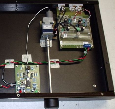

Here's a layout but has an active pre.... igonore that and it's a passive.

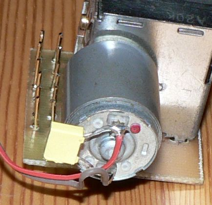

Rabbitz, what do I need to do with that 10nf MKT cap?
The 10nF goes across the motor terminals.... see the pic below.

Just double check you have the pot wired correctly... looking from the front:
Right pin is IN
Centre pin is OUT
Left pin is GRD

I got the wiring wrong then ...
I treated centre as GND and the end pins and in and out! I'll have to fix this and try it again, thanks 🙂
Question: is there any real purpose to a preamp except for gain and volume/balance control?
Suppose I don't need the gain and balance ... what do I lose by not having a preamp?
Put another way ... what is hard about getting a passive pot right compared to a preamp? How is it different?

Aside from gain, preamp can provide two things, high impedence to the previous stage, and adequate current (low impedence) to maintain the voltage signal into the next stage - in other words, a buffer. The usual rule of thumb is that the input impedence of a stage should be at least 10 times the output impedence of the previous stage. With that ratio you shouldn't have gross distortion, but a higher ratio might sound better. Add a buffer to your volume control, and you have a "preamp" with no gain.
Sheldon
In theory a pre amp only needs a volume control which a passive can do but there are problems with matching the source and amp impedance and driving the low level signal cables especially if they are longer than 1m.
Passive when working is very yummy and I have 2 amps working that way which are LM3875 chipamps with the pot inside with the power amp. I've tried it with bipolars and it didn't work for me and ended up with a rolled off response such as loss of some bass, so active was the way to go and I just used a simple design using a OPA2134 op amp for 6dB gain.
