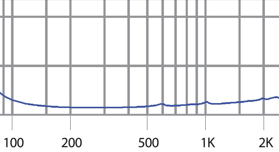

Sorry I don't explain correctly The graphic is only the woofer without crossover at 97db 1w 0.5m, I though that to have less that 1% at 97db 1w I is not bad for a two ways 12 inch and match correctly with the Audax TW034 but of course the sound is always improvable 🙂, I aprecite your opinion about how to reduce if is possible the 3rd harmonic distortion 500-1000hz

I'm guessing that's third order? Looks fairly normal for a driver with a more basic motor system.

The 3rd harmonic distortion plot of the Faital 12PR310 correlates nicely with irregularities in the impedance curve at 600 Hz and 1000 Hz. Many drivers suffer from a surround resonance in this frequency range. The resonance is often accompanied by elevated distortions. I don't think you can do much against it. Perhaps coating the driver helps, but the risk of ruin the driver is high as well.
3rd harmonic distortions close to 1% around 1 kHz are audible and are a problem. Once your brain begins to focus on them the fun is over.
AFAIK changing the crossover frequency doesn't reduce the distortions in the passband.
