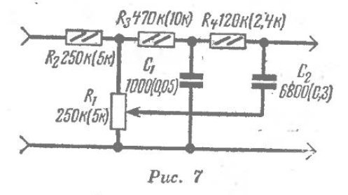

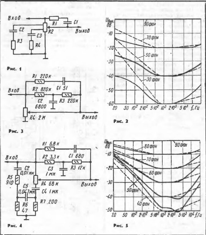

Hi, mfaughn,
Here are another schematics for volume control with loudness, without using tapped pots.
Frequency response shown next. Please note third schematic doesn't have "0" (mute) level.
If you wish to change RC values, no problem. For example, if you increase R values by a factor of 5, you will need to decrease all C values by the same 5.

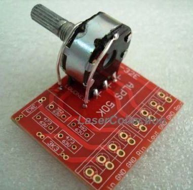

How To Add This
I have a tube preamp that has room for this 21 stepped VC with loudness tap and circuit board. It currently has a standard stereo VC with no loudness. I do have an open un-used on-off button on the front panel. Can I just pull out the old volume control and replace it with this one? How would I wire it to the switch so I can turn the loudness function on and off?
These are readily available on ebay.
Picture is attached.
Thanks in advance.
Thanks in advance.
