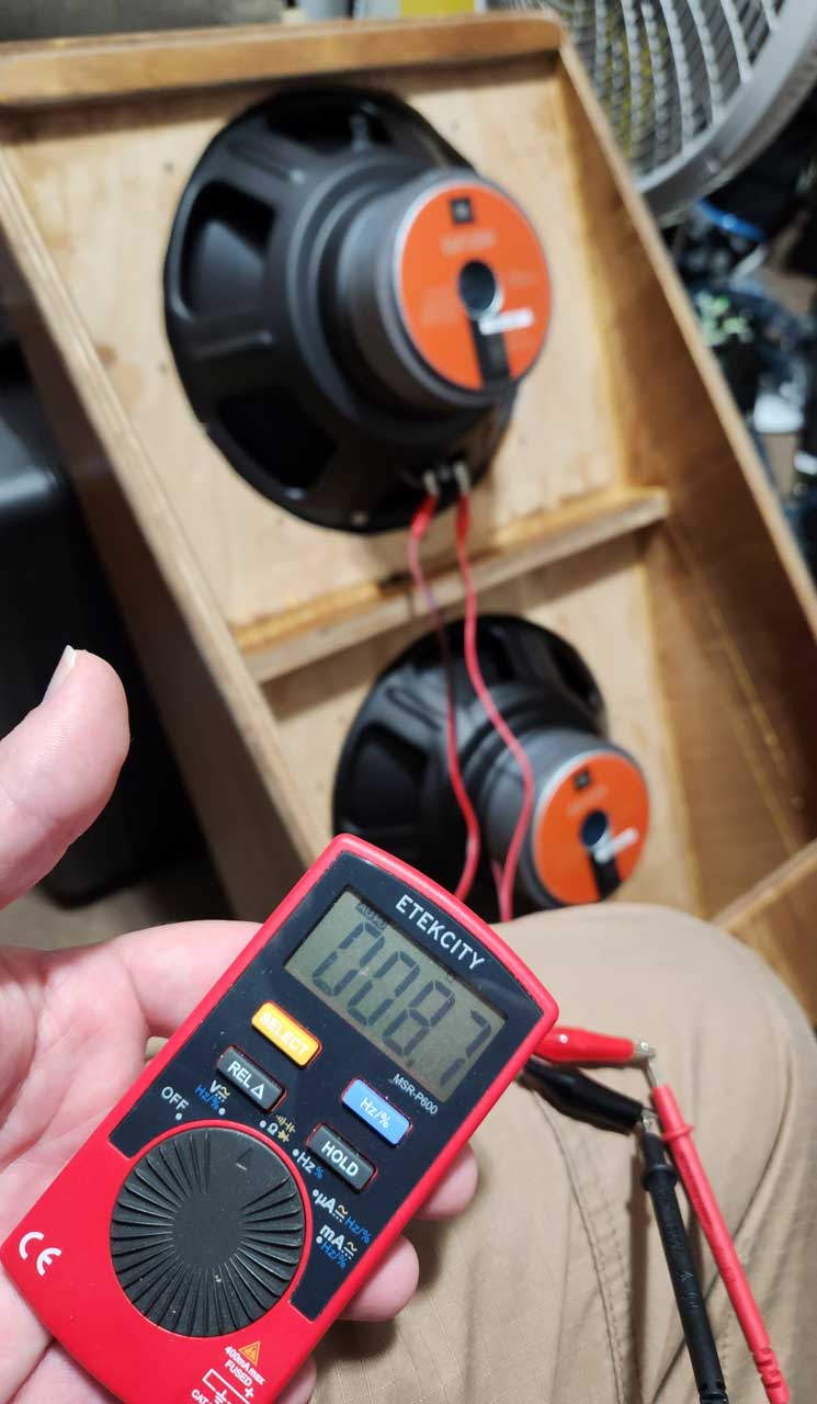

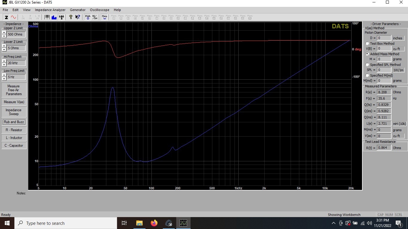

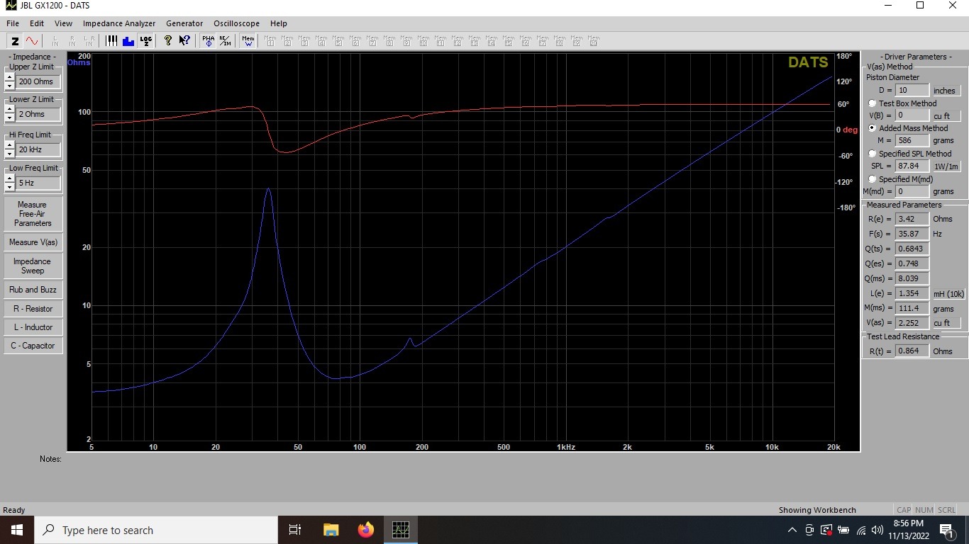

Funny I was just wondering about this subject. I was wondering besides the final resistance load the amplifier see's, what other things there were to consider between wiring in series vs parallel. It was the idea behind taking advantage of the statements you made above about drivers in phase that are parallel vs series that are 1w@2.83v and that drivers in parallel will have +6db while in series will have +0db.
I recently picked up a pile of cheap JBL GX1200's in that sale to tinker around with. I did an open baffle with two of them and wired them in series since that's all I could do and still use it with my amplifiers (I don't have spare 2ohm stable amps).
I measured them to see what would change:
Here's a single JBL GX1200 with all its free air parameters too.
Then I wired two in series (4ohm each) and the result here on my multi-meter is 8.7ohms. Since the amp see's this as the load the output goes down and per your table I don't gain the increase in SPL from the two drivers ultimately because while I do, it's lost again due to the output loss from the increase in impedance.
Here's the two drivers wired in series on the DATS to show what changed. I guess now I'm curious how to interpret the Q values relative to the information above because they changed but the information says the parameters should cancel. But these changes do have meaning do they not?
Overall my take away from all this is that for sub woofers it's not a good idea to wire in series and it should basically be used to also wire in parallel. It definitely got me thinking. Instead of trying to build things with two drivers in series that are 4ohm and become 8ohm, it's better probably at least in most situations to have 8ohm drivers and wire in parallel to 4ohm to get the increase in SPL as intended.
