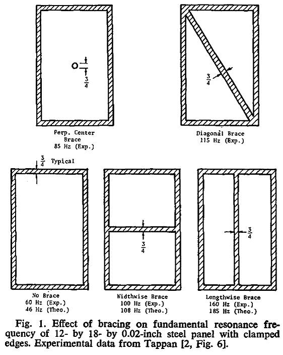

The braces in that box would be much more effective if rotated 90° to follow the guideline: The subpanel created by a brace should have a higher aspect ratio than teh peanl which it is bracing. The sub panel aspect ratios should be different.

Maybe I am not picturing the aspect rule properly. The enclosure is almost a square on the side so the aspect wouldnt change much. The pics dont give a good perspective.

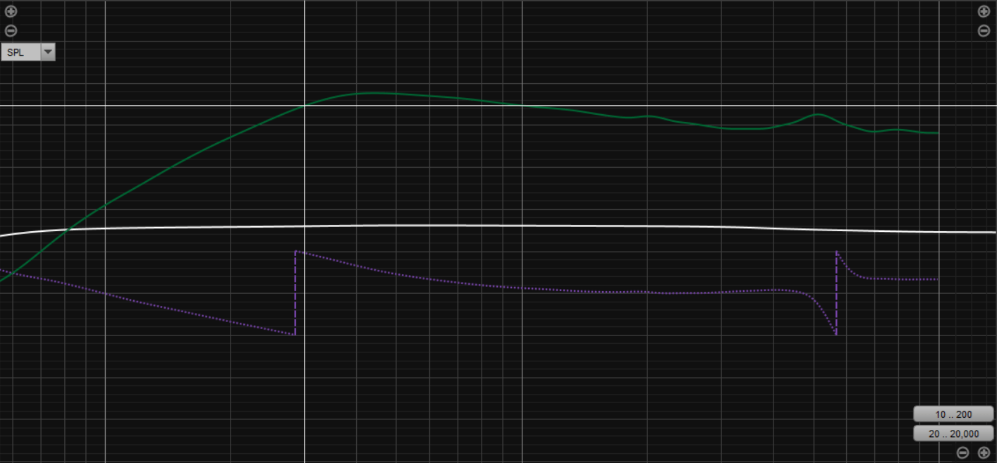

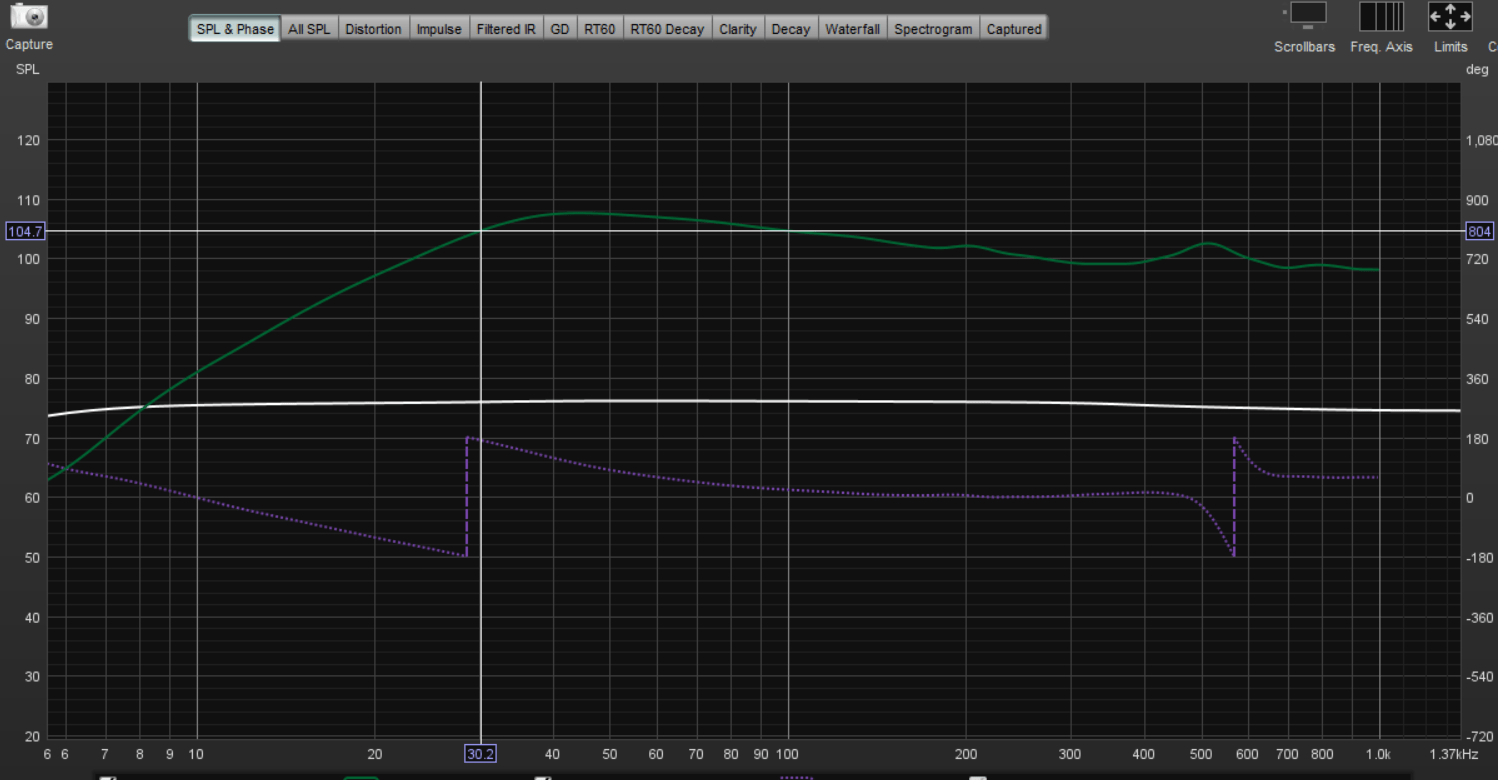

@planet10 I see what you mean. The box is ~30x30x20 for ref. It measures like the tuning was not affected by it.
Measurements suggest that the skimpy windowing did not affect anything.
However there is a serious ring at around 200Hz. Not audible above pink noise but precarious. Tap test suggests its the cone. Im hoping my endeavor of adding some stuffing will help damp this out.

This is the diagram pulled from the AES paper that leads to the guidline i posted early on.
