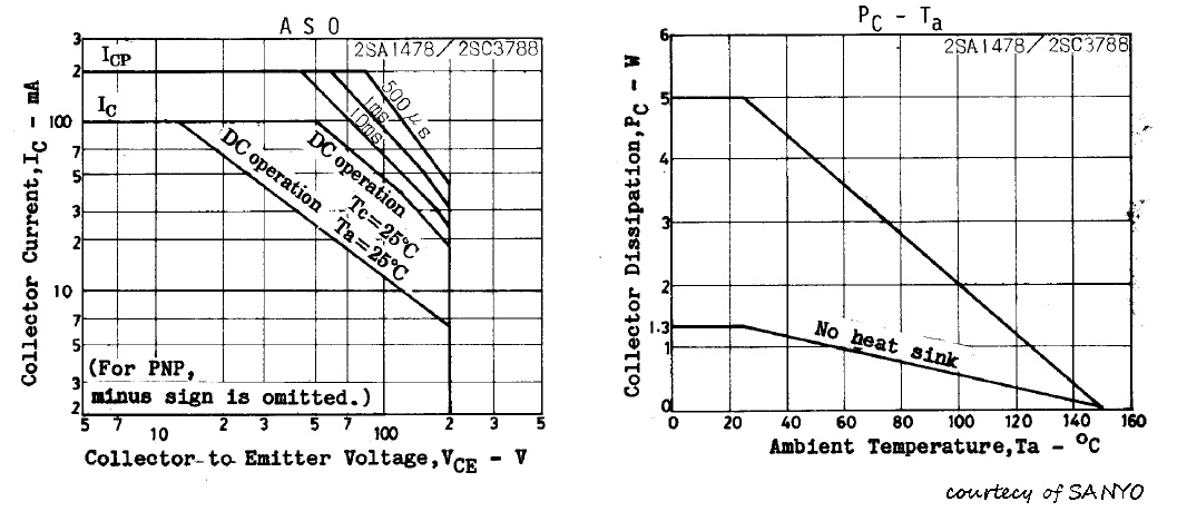

Im using a pnp LTP to drive a single pole VAS 2sc3788 (might change depending on advice), pre driving 2sc4793 and compliment with 2 pairs of 2sc5200 and complement final into 6ohm load.
Was using MJL3281 and compliment and MJL21994 and compliment on other projects, but after seing many use 2sc5200 on this forum I had a look at them and they 1/2 the price of MJL21194 here, and for this project they more than enough.
I want to know how much current I should set my Vas transistor at.
LTP is biased at 1.5mA per tail atm. And Final transistors at 30-40mA per pair.
Supply is 50-0-50 DC unregulated, heading for 100W into 8ohm.
I was thinking of 20mA for Vas transistor, to maximise output.
But im scared that would lead to the Vas running hot.
As I have no experience with this Id really appriciate your advice.

VAS Pq is = +ve supply voltage * Ic. That would be 50 * 20 = 1000mW. That is hot even for a To126. It needs a sink.
Another question pls.
2sc3788 vas : VceQ = 50V, with max signal running to close to 0 and 100V.
Do I use derating curve on 50V im guessing average voltage over ce.
or do I use Vce(max) approx 100V.
I could just use 100V to be safe but Im using this as learning experience and
so want to use the proper value and calculate smallest heatsink,
even if i end up using a slightly lower c/w heatsink.

Your LTP transistors will dissipate 75mW each , that s quite high ,
you can reduce the current to 1mA/each without entailing the perfs
providing you use a compensation cap that is reduced by a 1.5 ratio.
As VAS current 8 to 10mA are enough given the high beta
of your drivers + power transistors.
Even with such low currents , it would be cautious to give
the VAS and its eventual current source a little heatspreader.
