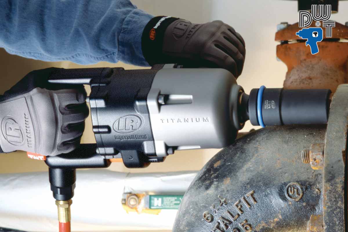

I wasn't sure wether it was just tight or veeery tight.
But, as you say, the range is so wide that it should be ok to go as far as you want it to sound good afterwards (so don't exaggerate, it's not shipyard work...)
My first (ACA, recently) was way too loose, but all went well though 😛
(PS: The experts are explicit: _don't_ use tools like in the image below)
