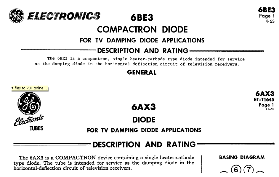

In my project I'm using a bridge (pics below) running choke input filter to give ±275V from a home made toroidal transformer. They are 6AX3 or 6BE3 tubes (same heater rating) but the former have higher anode dissipation, copper made. The former are clear silver-like metal.
Osvaldo, the two tubes you mention are designated as rectifiers, not as damper diodes, so I'd expect their warm-up time to be faster as they don't have special cathode insulation.
My argument remains, that damper diodes are not recommended as rectifiers because of warm-up time rather than any other limiting factor.
mea culpa
Osvaldo,
I was too quick in my glance at the data sheets. Even though the sheets I read said "half wave rectifier" you are quite right that they are designated as damper diodes.
So the next questions is: Why do these types warm-up faster than others?
And the next question: Where can I buy some? 🙂
I believe that they had been working in better metals/alloys. And perhaps the need for competition with transistors. I knew about tube TV that never turned off heaters completely to accelerate start up, say, have pic in the CRT.
