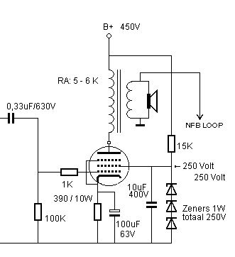

You need to connect the screen to its own stabilised supply. In the schematic below, the author uses Zener diodes to keep a constant voltage, however, you would need to calculate what voltage you need (your B+ is much lower.)
You could just try using a 5-10K or so resistor and a 10uF cap without the zeners, that would work fine...
Also your distortion would be higher, you might want to use some feedback.
All these things are very easy to do, you might as well experiment!
I don't recommend using resistors: you loose regulation, and this means the screen voltage will be pulled way south at maximum output. Besides that, any lower screen voltage than as before will require a rebias, and maybe even a different load impedance for maximum power output as well (not like that will make much difference anyway though).
