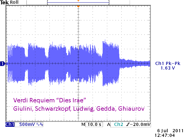

I was playing the Verdi Requiem -- the "Dies Irae" is one of the loudest choral passages in memory -- decided to put it on the scope -- the result is about the same whether I use my cheappo Samsung player, or the high end Sony SACD player. The first 4 peaks are the tympani:
Cool. My St70 manual indicates 1.3v rms in for 35 W out. 1.3X1.4=1.9v peak each way around zero. You're showing about 0.8 V peak, one way. This signal will need a little boost in the preamp to max out the ST70. My Pas2 has 340 V headroom on the low gain 12AX7 stage, my RA88a disco mixer has +-7.5V supplies on the op amp low gain stage. NO PROBLEM.

CD and other digital sources have a built in limiter. The output can never be greater than the analogue equivalent of 0dBfs.
Most CDP have an analogue output for 0dBfs of between 2Vac and 2.2Vac (~6Vpp, ~3Vpk). A test disc and a DVM will confirm the maximum outputs from your digital sources.
The only way to get higher than this is from interference being added to the audio signal. Just take action to ensure the interference is kept at a low and acceptable level.

It's track 3 of the Verdi Requiem "Dies Irae", on an EMI CD with Giulini in the drivers seat.
Another test using my test CD and the scope, @ -20dB FS is 254mV.
is that mVpk or mVac?.....CD and the scope, @ -20dB FS is 254mV.
pk-pk
this was the "warbled 1kHz -20dBFS" test tone on the stereophile test CD.
As I mentioned earlier 0dBfs is ~6Vpp.
-20dBfs should therefore be ~600mVpp.
It seems the DVM is seriously under-reading the peak voltages of that warbled signal.

It's a just a preamp question -- how much input voltage should the preamp front end be designed for -- my FM tuner is way down from the output of the CD player, so the CD sets the extreme.

I observed it on a TDS3014B.
if the input to the pre-amp is the track of the volume attenuator then the power dissipation of the track determines the maximum input that the pre-amp can accept. I would expect a domestic listening pre-amp to accept at least 10Vpp (~3Vac) but I would aim much higher, capable of accepting 10Vac.It's a just a preamp question -- how much input voltage should the preamp front end be designed for -- my FM tuner is way down from the output of the CD player, so the CD sets the extreme.
10Vac into a 10k pot results in a maximum dissipation of 10mW (10^2/10000=0.01W). Any half watt pot can easily accept 10Vac or even 20Vac.

The specs needed for a DVM to measure transient signals is for it to have "True RMS" AC voltage capability. The 2nd function needed is for it to have "Record Min/Max"...this capability registers the maximum transient signal at a preset time interval, otherwise you will be looking at an ever changing value or in other DVMs average value. Then Vpk=Vrms*1.414
For a "digital" source such as CD the "overhead" needs be only what the CD can output when the disc is recorded at 0db. In simple terms, if the max level is 2 volt RMS from a particular player then the preamp will never ever be asked to handle more than that. It's cast in stone. 2 volt RMS is a typical level although some players do have more output.
All you need is a test CD recorded at 0db and measure the output from the player. If the frequency is low, say <400hz then any DVM will measure it.
