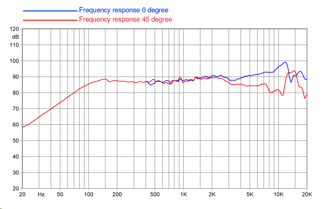

OK, I will target L-C-R to 80 Hz, although I had in mind 2x FaitalPro 3FE25 in parallel. This full range drops about -9dB at 80Hz:
I though I would go away with a cheap full range. hmm
Waste of money. Your L and R will have to play clean and full to 40 Hz, which not a lot of good speakers can manage (if the truth be measured). Obviously your otherwise good FR won't work for 80 Hz but just fine for 140.

Possibly in a lab setting, people can just barely exceed random guessing at 80 Hz. But in real life with L and R and a screen in the middle, not a chance you need less than 140 Hz (with clean speakers and steep slopes).
Excepting people who claim they are clairvoyant or have special powers of hearing, many have posted here about being fully satisfied with highish freq crossover.
