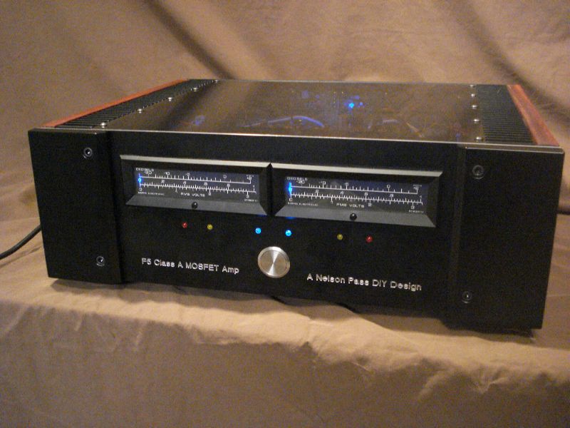

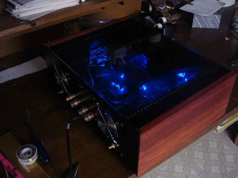

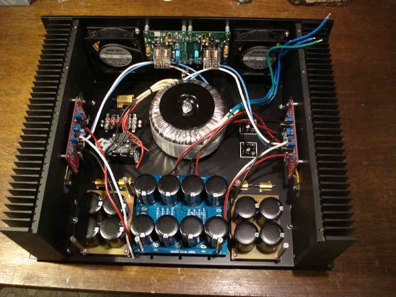

I built the F5 using Conrad heatsinks, Antek 400 VA transformer, added PSU stages, heatsink temp LED alarms, speaker protection and clipping (Class A going into AB) LED monitors. Cost for all that was about $600 (US).
I did my own chassis fabrication, to include the heavy aluminum base and rear apron. The front panel work was done by Front Panel Express, and I did the acrylic top plate, and African hardwood sides. I got my two Weston VU meters for about $60 (US) some 30+ years ago; these meters are extremely rare pieces and if you can find them today, they go for about $400 each.

Do your end plates impact the thermal efficiency of the sinks of your F5? Doing mental gymnastics I can make arguments to myself that they would both increase the airflow by making a more efficient chimney and block some cold air access. Curious what impact if any other than looking good?

Bob, I have two low-flow, low-noise muffin fans on the rear apron of my amp. They effectively "pressurize" the internal plenum of the amp (flowing air around the transformer, electrolytics, power resistors, etc). From there, I have machined channels at the base of the Conrad heatsinks to allow the chassis air to exit, and flow upwards between the heatsink fins and the wooden side panels. The resultant forced-airflow keeps the amp running very cool--and one of these days I'll probably crank up the bias in search of "sweeter spots" on the MOSFET curves. (I recall "This is Spinal Tap"....MY amp goes to 11.....!!)
CanAm Man's amp ( say that three times fast...) has sufficient airflow and proper thermal protection that I would not hesitate putting a F5T or many-output BA- into that chassis.
And those VU meters are soooo cool its beyond amazing.
