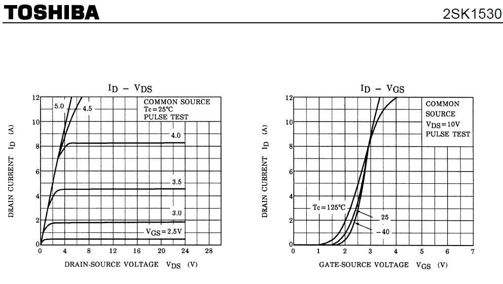

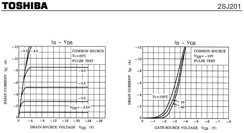

MOSFETs are driven with voltage, not current for DC biasing.
The jpg's show approximately how much voltage should be applied vs drain current.
The one on the right shows typical Vgs for variations in die temperature.
Gotta love data sheets.
As Dug says, FET's are voltage rather than current driven. At DC they draw no steady state gate current. You could feed them via 10 or 100Meg, but that would be no good for audio...
At AC you have to supply (or have available) enough current to charge and discharge the gate capacitance. Not enough and the output stage will suffer slew rate limiting and restricted HF response.
