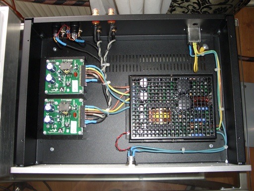

My ucd400oem in modushop case runs for more then a decade. Just mounted on the metal bottom plate.
But ucd400oem on small heatsink with 1000w smps on bottomplate also functions.
Ok, thanks, so no need to worry about the ucd400 or the smps! I think I might need to add some extra cooling to the ucd2k though as it looks very small, the heatsink standard on the board.

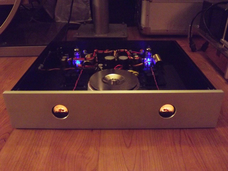

Very nice tube opamps, love the "eyes" you have now on the front plate!
