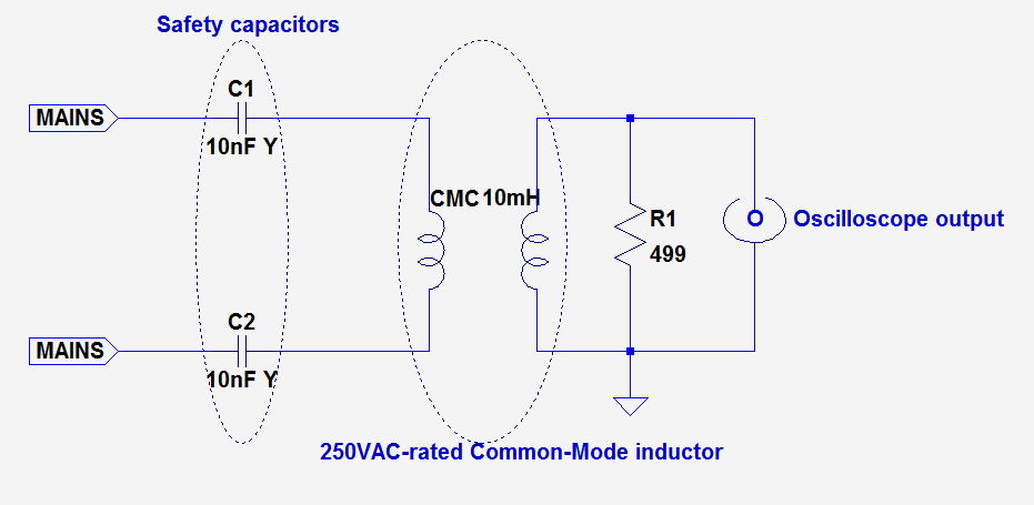

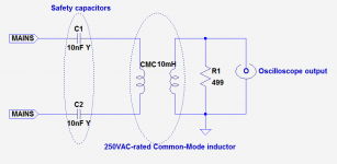

Mains transformers are not ideal for that purpose: they degrade the frequency response above a few kHz, and distort (a little) lower frequencies.
In general, disturbances are high frequency, which means you can get away with some short-cuts.
One is to use a common-mode choke intended for mains purposes coupled with "Y" capacitors.
attachment.php

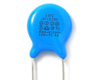

This will result in a second order high-pass filter, useful for removing high amplitude, low-frequency voltages, and will provide a double insulation barrier for safety: one is not completely regular, because X-rated components should not be used for Y applications (unless they are certified for both, which is not uncommon), and the other, Y caps, are OK, but on their own cause earth leakage which can be annoying for metrological applications.
If your test gear is earthed, this setup is completely safe, if properly built, of course.
If you have doubts, ask the necessary explanations, don't risk your life.

A Y capacitor looks like this:

Be sure to respect a good safety distance (>15mm) between the mains side and the measurement side.
