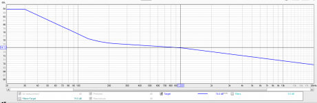

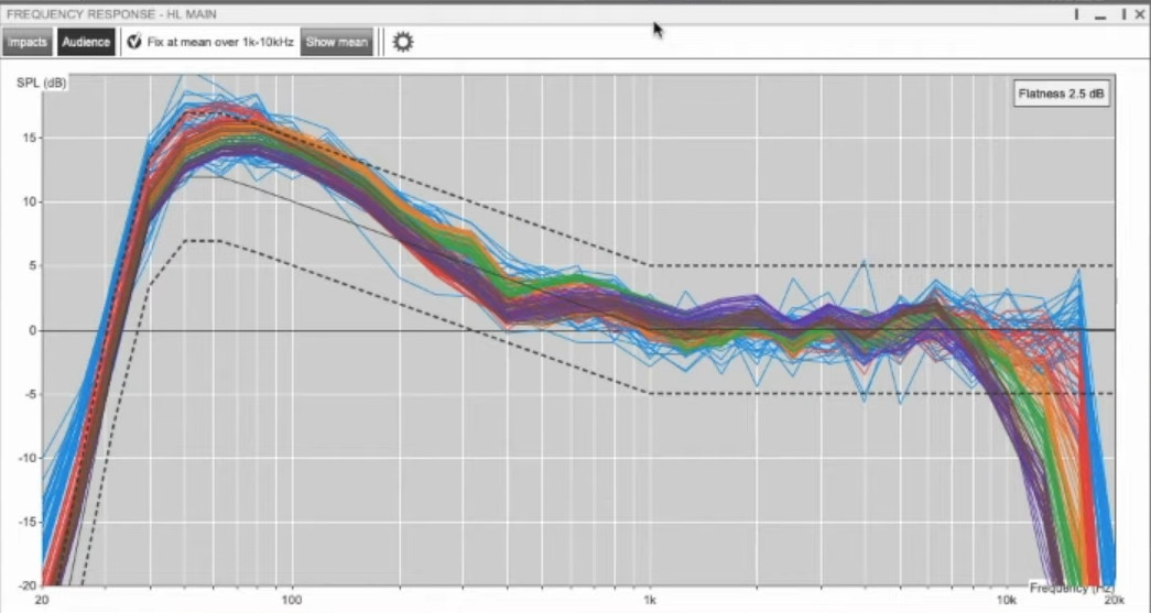

Thats a spicy target +12.5dB (and it looks like the holywood bowl tuning is more like +15dB) at 40Hz but does correlate with what I end up running for recorded music playback in a club.

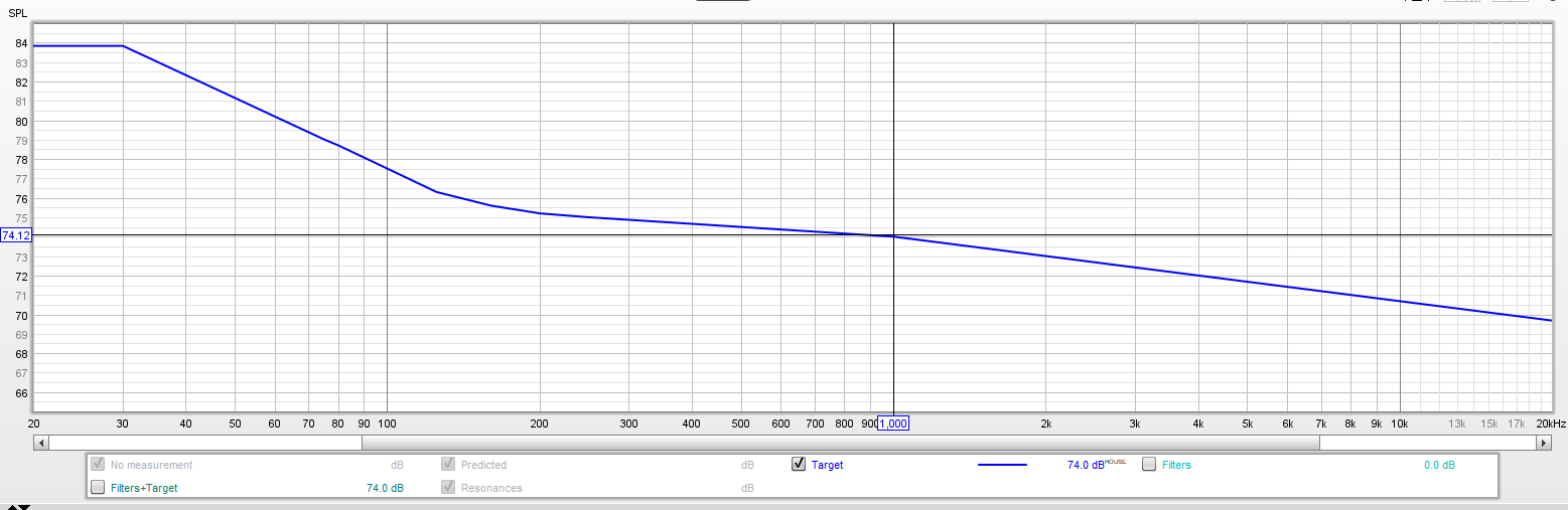

My home target is:
20 8.829695786
25 8.829695786
30 8.829695786
35 8.018092456
40 7.315049674
45 6.694921991
50 6.140198876
55 5.63839078
60 5.18027588
65 4.758851024
70 4.368672551
75 4.005425082
80 3.7
100 2.5
125 1.3
160 0.6
200 0.2
250 0
1000 -1
32000 -6

It’s pretty close to the equal loudness contour shape for a 90-100 phon level, as I see it. Depending on the content, I’d like a system with the capability for much more spectral tilt; at least headroom-wise, so that when a newer act comes on with plenty of keys and synth I don’t find myself slamming the limiters for the entire set.
If the show is going to be mostly electronic-based acts, my system designs tend toward a 3-40 dB ‘max SPL’ target difference for subs versus mains. Neither should hit thermal or power limiters any time over a 16-hour run. I like headroom!

I noticed later on in the video the target was different in that the upwards tilt moved to 400Hz. I attached my target as an image.

I don't tend to use a target curve myself. There are too many variables in a venue to make it trustworthy. I'd rather spend the time chasing down aiming and alignment issues than making a curve for something that worked in one place with a different RT, structural makeup, content and such.

In the book "Sound Systems: Design and Optimization: Modern Techniques and Tools for Sound System Design and Alignment" which I recently got Bob McCarthy discuss spectral tilt in system EQ. He views it as a kind of 'distance to speaker' parameter as its analogous to the HF absorption that you would get with distance. He specifies a broad range of 6dB - 24dB and states that the required tilt depends on the reverberation time (as another factor affecting perceived depth) and the desired 'distance' from the speakers. Seems an interesting idea I should probably program in a few different DSP presets next time I EQ a system to see what the effect is. I use flexible floating point processing so I should probably be EQing the system flat and then adding contour EQ on top to make all this easier.
