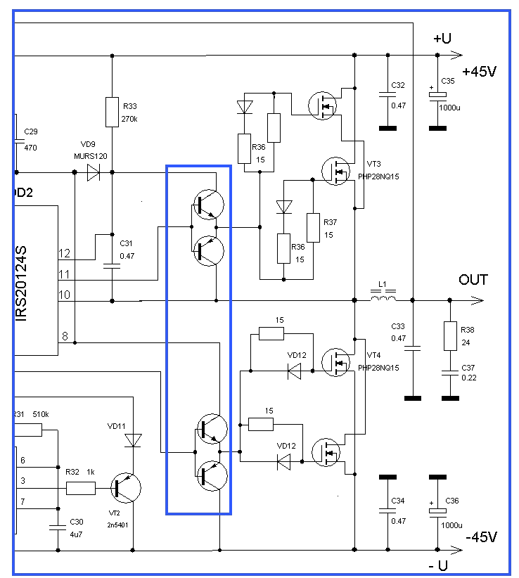

hi. I decided to build an auto amplifier.From datasheet result max load on LO and HO is 1A. I want to use 6 x IRFB4227PBF (3/rail). Somebody can tell me if IRS20124 can drive this transistors.

Yes, this buffer style works. Zetex produces suitable bipolar transistors.
Using one buffer for each IRFB4227 will allow high switching frequencies.
Why do you think that you need IRFB4227 triplets instead of pairs or singles?
well.. I want to use it into 1ohm load and I'm not sure that the 20124 can support the current necesary for the mosfets
