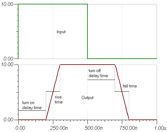

Pafi said:
This is not true. Timing error caused by fall and rise time depends on output current in a nonlinear way, no matter PWM or sigma/delta.
Pafi,
While true that there is a non-linear dependence of the rise and fall times with output current (which I believe is affected by the amount of dead-time you put into the output driver) This affect is secondary to the error caused by having a delta sigma scheme in which the switching frequency is related to the output amplitude.
Let me know what you think. Im open to all criticism.
CLD
dusfor99!
Sorry, I haven't red your statement carefully. Now I've done. You are partly right, there is an effect causes distortion due voltage dependent frequency, but in practice this is typically a very weak effect compared to others (eg. effect of dead time), arises only at really high output voltage, generates only low order harmonics, and can be reduced effectively by a very simple computing in digital domain.
I thought you were talking about one of the main reasons of distortion: dead time induced distortion, wich arises at low level, generates high order harmonics, and cannot be predicted (so cannot be reduced) based on input signal. This distortion arises at every kind of modulation.
BTW: you seem to use different definitions as usual. Please check attached file!
The error you referred to doesn't only depend on rise and fall times, but on difference of delay times too.
Yes, I totally agree.
