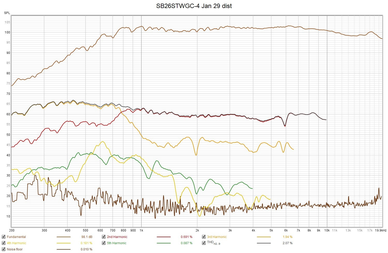

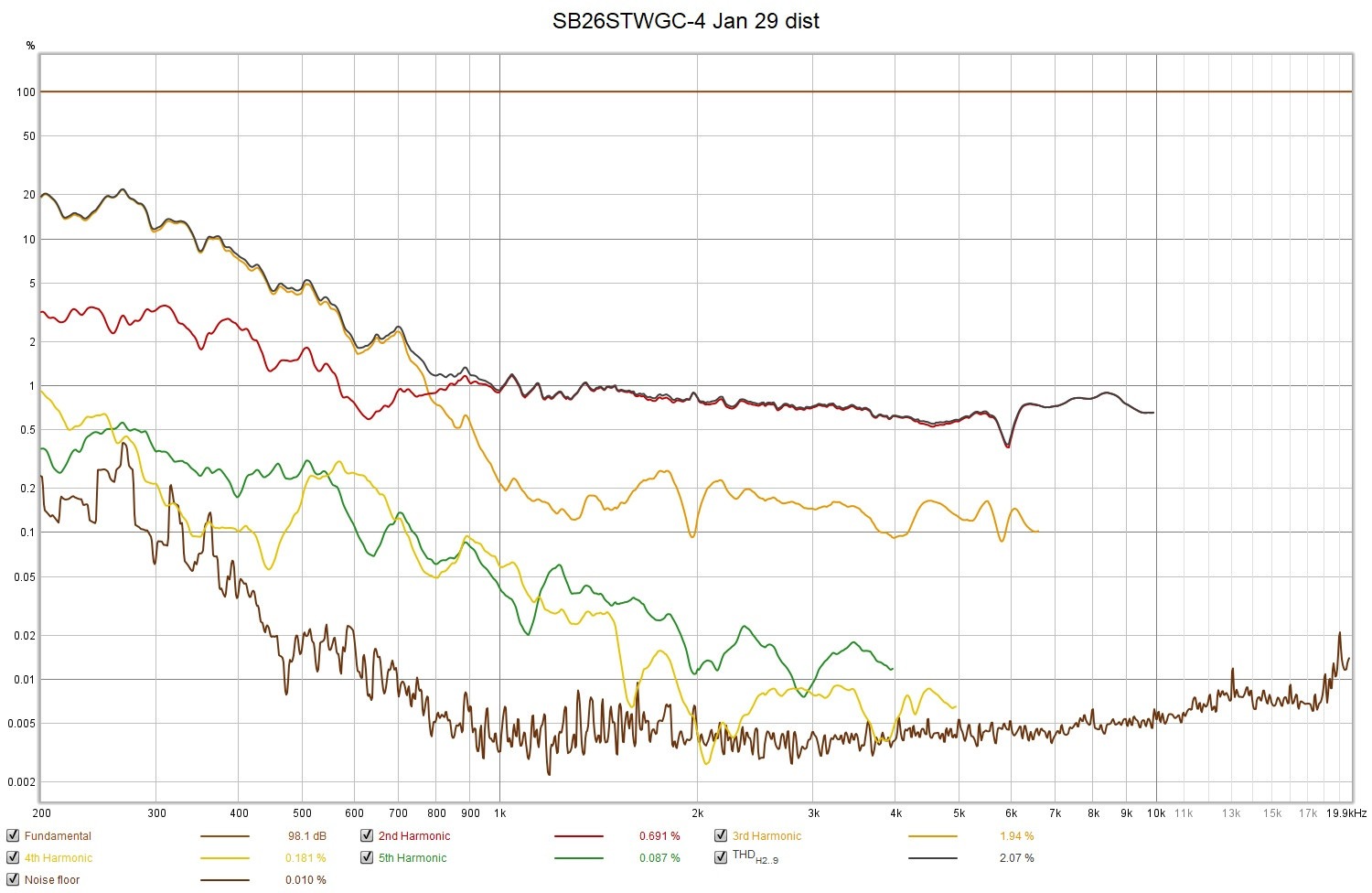

Can someone explain the below graphs and how to determine 'where distortion starts':
Distortion 2.83 volts, 315mm:
From what I think I see, distortion is rising for some harmonics below 2 kHz (the green line and lighter yellow - 4th and 5th, I think). The levels look relatively low, but they are increasing, so if you want the least distortion you may want to stay above that range.
Forgot to address this earlier: volume displacement is typically what you want to look at (Sd x Xmax). You can calculate maximum output with that, so is a good thing to check to if you think you're going to be near the driver's limits (high output systems or those that are using drivers at lower frequencies than typical).5. Take into account the Xmax
for simplicity and clarity you could hide all distorsion graphs except H3 (and eventually H5).'where distortion starts':
that's the most revealing one and also one of the more annoying audible ones.

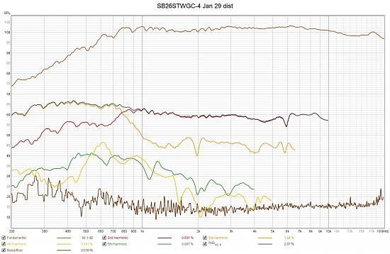

Apologies!Looks like 1kHz is the knee. But could you increase the size of your pics, please. These are illegible.
Here are the larger files:
from the graphs, it can be seen that the H3 rise confirms the old 'octave above Fs' rule of thumb, remembering that any reactive components in the Xover need to be well above the Fs resonance as well.

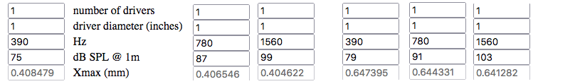

At one meter, the driver has reached ~10% distortion at ~390Hz at ~75dB.
Reduce level by -6dB for each doubling of distance, at 2 meters 69dB.
A doubling of excursion is required to increase SPL by 6dB.
Four times the displacement (excursion) is required for each halving of frequency to maintain the same SPL.
At the drivers Fs of 780Hz, at 1meter we could expect it to achieve around 10% distortion at 87dB.
An octave above (1560Hz) at 1meter we could expect it to achieve around 10% distortion at 99dB.
If we use this excursion calculator
http://www.baudline.com/erik/bass/xmaxer.html
we might expect 3-to 4dB more output than the above when the driver goes a bit past Xmax:
