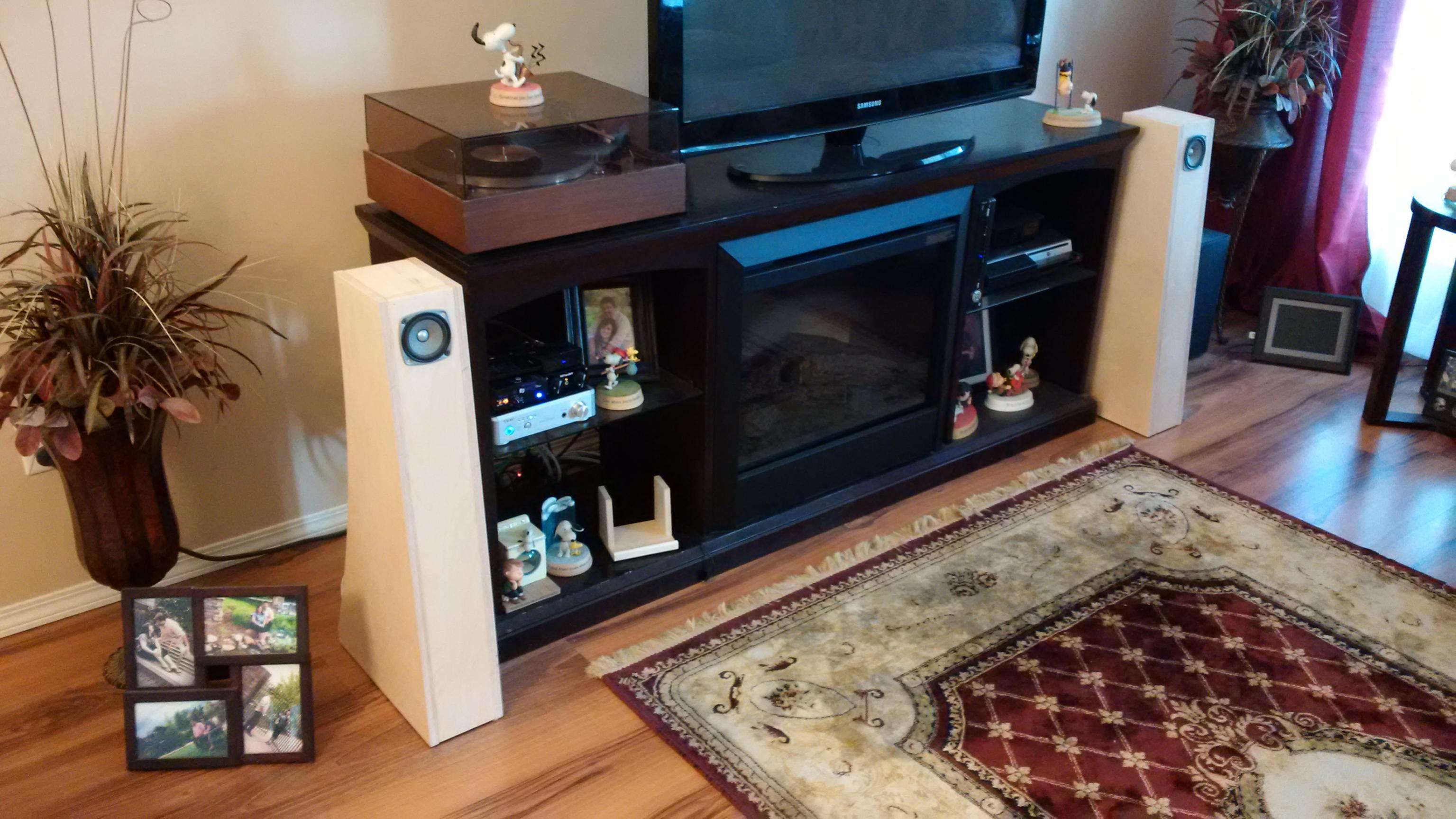

FE83 or FE87 do not go low. You can sensibly get maybe 150 Hz.
The FF85wk is the bass king here, and IMP souds better.
Wither this or the almost unobtainium FE8x SOL) is a FH-lite is capable of 65-75 Hz (at a level limited by the cone size, in the horn, mote than you would expect), but it does have to be noted that room placement and room gain make a big difference.
Frugel-Horn Lite for 3" drivers
490567d1435338662-frugel-horn-lite-3-drivers-img_20150626_103051-jpg
dave
Right. GM has given the technically correct data (down to the lower mass-corner Flc, assuming a full-sized, reactance-annulled hyperbolic and zero power-handling worthy of the name). Ejecting all semblence of engineering sanity, you could stick one in a very low-tuned QW pipe -one tuned even below Flc, but it's not exactly recommended. While it will make noise (prior to expiring), it won't do it very loudly, nor would the resulting alignment be what you'd call pretty. 😉
FH-lite works well with the 85 (a very nice little unit), or one of the other design drivers. While no bass-monster, as Dave says, it doesn't do a bad job at all for such a small speaker. To my surprise, the last hi-fi show I attended in the UK a couple of years back had (as I recall) 3 rooms running them, either as the main units for the weekend, or as an alternative to a different set of speakers. Quite a few walked out of the different rooms scratching their heads that a 3in driver can produce so much sound. These things are relative -they aren't going to beat a full customised vintage Altec setup with a couple of 15in woofers & compression mid-tweet per channel. 😉 But in a small space & at modest levels, they do a good job for a little 'un, although I say it as shouldn't. 😛
