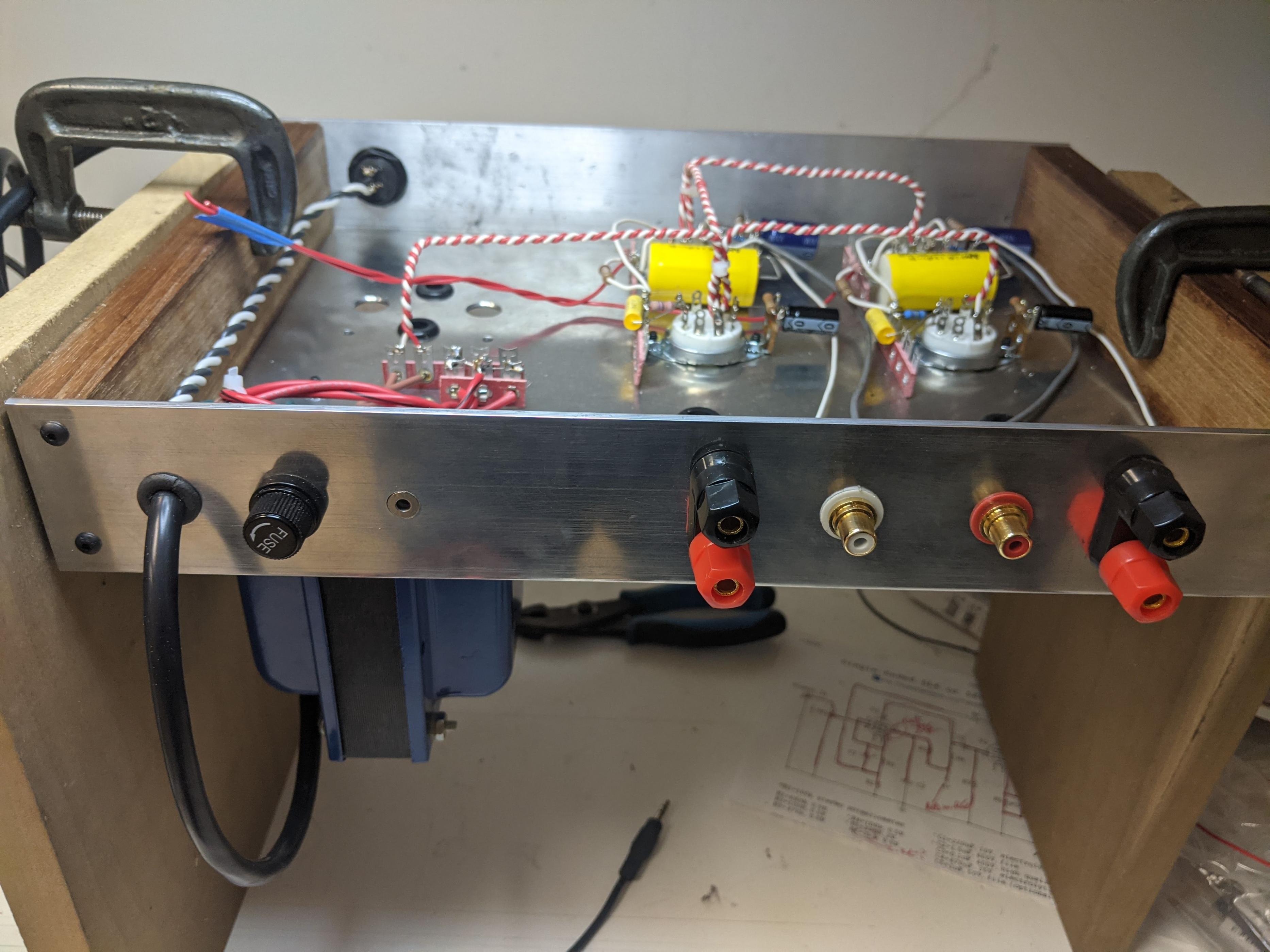

Quick question (I believe). I built a preamp with 2C22 and #76 tubes. There are specs as to how far out of level one may run these tubes but what about for testing? Can I set the unit at a convenient angle for a few, maybe up to 15 minutes, for measuring purposes or is that risking damage? This question is really in general not specific to these tubes.
I can certainly hook up my test leads and measure once the amp is level but that is somewhat labor intensive.

When testing an amp, I turn the amp upside down, use books at the corners to keep the tubes off the table, and that works.
Careful, do not knock the amp off the books.

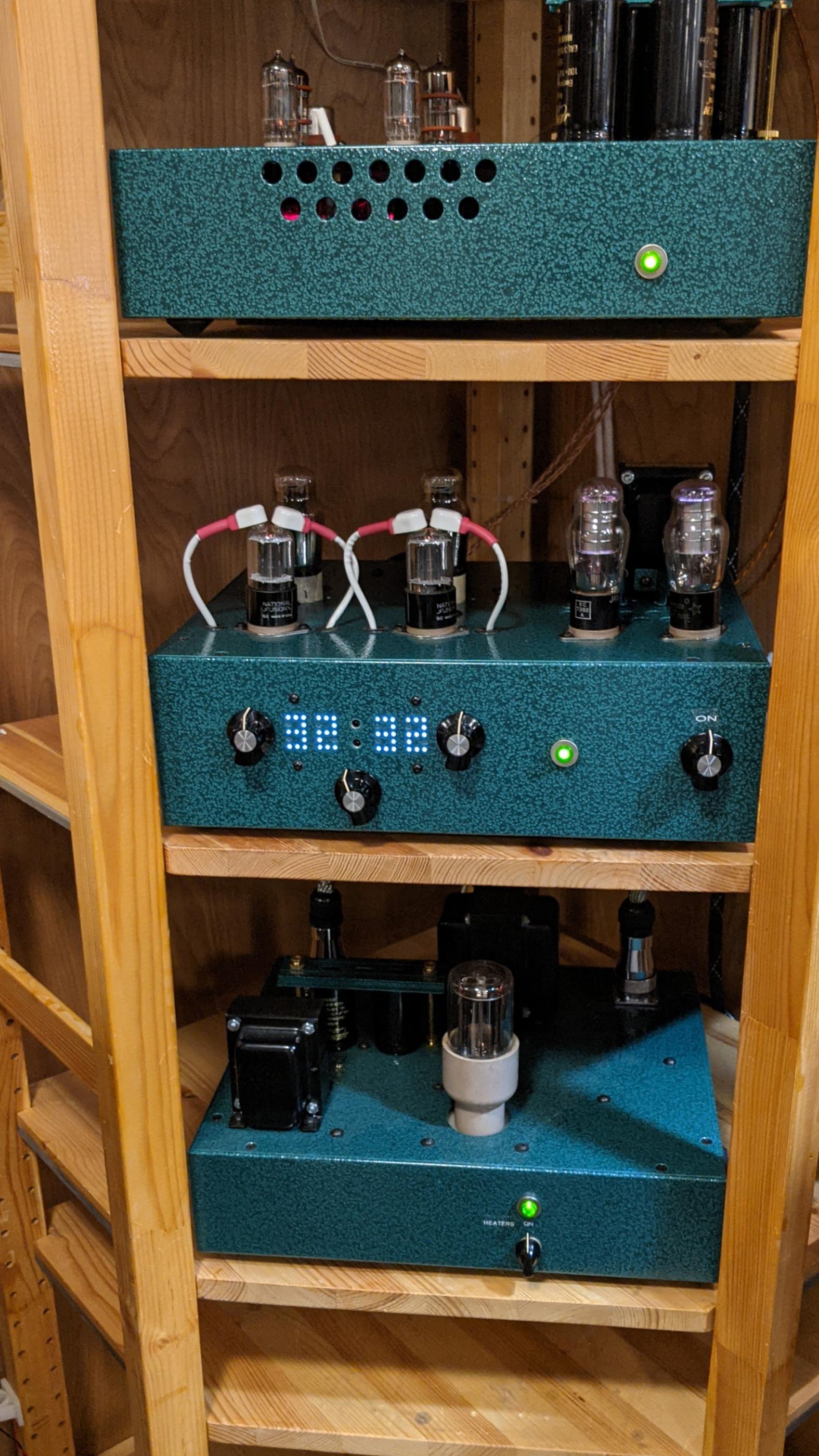

Yes I did post the tube types in the original text and I had checked Frank's data sheets prior to posting. The 2C22s have specs and I am adhering to them in their running orientation. I was just asking about during a few minutes of testing tube voltages as the location of the tubes, tube cap wires and transformer made balancing it on books precarious. Since you were so adamant about disaster I had the unit off, positioned the leads and then turned the preamp right side up prior to each voltage test. Took about 8 cycles but all sees fine. Unit in question is the unit in the middle of the stack.
I decided to splurge and by a premade amp stand for future stability.
