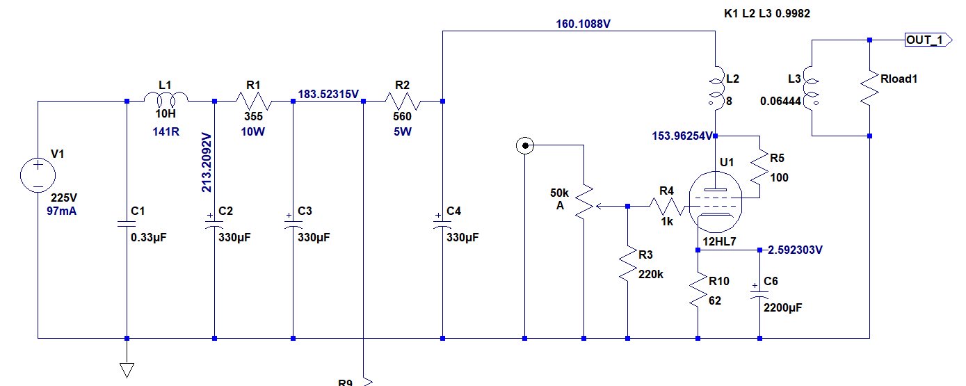

This is the schematic of the built amp. It's quite simple. Downright boring.
That's from a SPICE simulation, but the voltages in the made amp are very close (well within 10%, depending on the tubes being used).
The heater supply is plain old AC, from a center-tapped 3.15V-0-3.15V transformer. I have it lifted to +40V by a voltage divider. Hmmm... Perhaps the voltage divider lower resistor is too high of a resistance value for these tubes? Maybe I should just ground the heater supply center tap to 0V. The cathode bias is only about 2.5V, so that's not an issue.OldHector said:My understanding is that these 'crackley' sounds develop because the heater-cathode limits have been exceeded in some way, and the insulation starts to fail over time.
I'll have to pull the amp out and open it up to remind myself what I did.

"The heater supply is plain old AC, from a center-tapped 3.15V-0-3.15V transformer. I have it lifted to +40V by a voltage divider."
Why?
Why?
Powered on at least a few nights a week, and the amp gets left on for about 8 hours, sometimes longer. I often fall asleep forgetting to turn off the amp. Sometimes I forget to turn it off in the morning and it's left on all day. And according to what smoking-amp just wrote, it does look like I'm being hard on them.How many hours would you say before the noise starts? 2 hours a day is like 700 in a year so if you are hard on them a year and a half might not be out of line.
Lower likelihood of hum from the heater supply, according to RDH4, Blencowe, Jones, et al. This is a headphone amp, so I was worried about any and all sources of hum, but I didn't want to add a separate transformer for a DC heater supply.pl802 said:"The heater supply is plain old AC, from a center-tapped 3.15V-0-3.15V transformer. I have it lifted to +40V by a voltage divider."

I wonder if these frame grid pentodes are more sensitive to max heater cathode resistance than other types? I have 27k ohms heater to cathode.

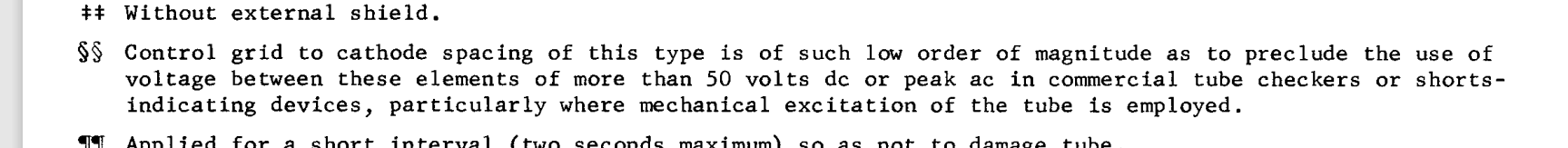

12HL7 has very little distance between the cathode and grid unlike other tubes, maybe elevating it is working against it life-wise? The spec sheet does say not to use a tube tester where the difference is as low as 50V even. Maybe disconnect the elevator wire, put in new tubes, and see if those last longer? You could add 10 turn hum pots to each tube to precisely null each tube, since it is for headphones and any hum will be really noticeable, unlike speaker hum.
I'm not understanding how the max grid-cathode voltage of 50V would influence the cathode to heater voltage limit. Are you thinking there's some kind of cathode to heater leakage current that creates a voltage differential between the grid and heater that becomes important?
