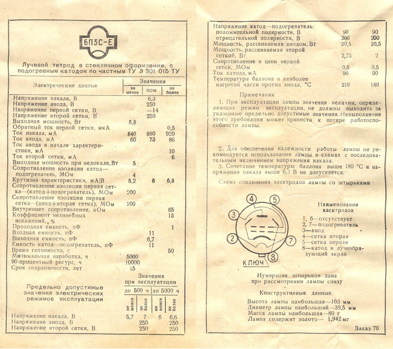

As for power valve lifetime, just check out the Soviet era Saratov data sheet for the 6L6Gx family equivalent, the 6П3С-Е.
This is a 6L6Gx/5881 equivalent with a design-lifetime of 5000 hours. But underneath that line, it tells you that there's a 90% chance it will do 10000 hours. Cool.
However, to get such a long life, you must respect the operating conditions that qualify the lifetime figure. From the 2-columns at the bottom left you can see the conditions that give 500 hours, and the conditions that give 5000. They're not very different!
In each case, you must keep Va & Vg2 to 250V. but increasing bulb temperature Температура баллона в наболее from 180 to 210 deg C, running high power in the screen: мошност, рассеиваемая, второи сеткои at 2,75W in lieu of 2, or slackening tolerance on the heater voltage Напряжение накана from 6..6,3V to 5,7..7,0V degrades life expectation from 5000 down towards 500 hours.
Given that guitar amps run these at about 500V and near to 100% of rated anode/screen dissipation, is it any wonder that they last only a few hundred hours? and why pro stage guitarists change them twice or more per year? And since ac-heated 6L6s will vary in voltage due to line voltages, how many can keep their mains to 5% accuracy?
So, if you have some nice old valves and you need them to last a long time, run the voltage and power levels LOW. 60 to 80% of rated maxima on each. Use current sources for heating, and ventilate the bulbs fully, or use fan cooling. Like Kevin, I've run many thousands of hours on old JJ 300Bs, and have followed these rules. In a guitar amp, that ignores the rules (it has to, to sound right) expect bad reliability.
When you design an amplifier, you sometimes have to decide whether it sound quality, power output, or reliability that comes first. Like many things in life, you can't always have everything.
