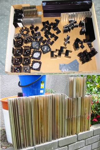

grataku,
At 1st, I only wanted to salvage the small heatsinks that can fit on a PCB. But after seeing the larger ones, I couldn't help not saving them.
All up, only cost me me $120NZ ($60 usd). The small transistor heatsinks alone sell for more than $5 each:bigeyes:
