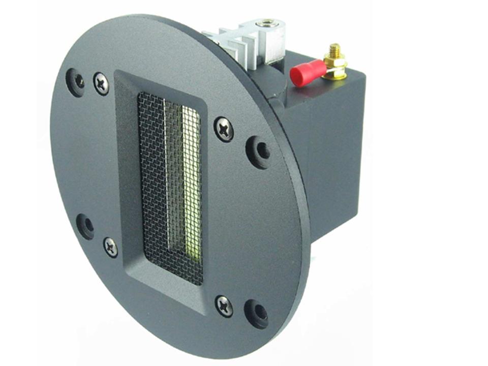

Caleb Chia said:How would they compare to a cheap commercial ribbon or dome tweeter, for the same amount of money spent?
Your requirements can easily be covered by reasonable cost commercial ribbons, so the educational value of DIY ribbons would need to be important to you for make vs. buy. Most of the DIY ribbons discussed on this site are larger or more specialized (like dipole).
http://www.madisound.com/catalog/product_info.php?manufacturers_id=132&products_id=1389
Fountek NeoCD3.0 ribbon tweeter $90
110mm (4.33") Round Metal Flange, Black, Depth is 68mm (2.7")
Super strong Neodymium magnets
Build-in impedance conversion transformer
Effective from 1,400Hz upwards due to the large diaphragm area and low self-resonance.
Thin enforced sandwich ribbon diaphragm guarantees a high degree of signal fidelity and broad frequency response.
Low distortion factor, good power-handling capabilities, high linear impedance and amplitude frequency response and the broad frequency response range.
Flat impedance from 1,000 to 40,000Hz
Specifications
Ribbon material: Enforced sandwich
Ribbon mass: 18mg
Ribbon dimension: 8mmX60mmX0.02mm
Ribbon area: 480square millimeters
Gap flux: 0.6 Tesla
Gap height: 3mm
Impedance: 7 Ohm
DCR: 0.02 ohm
Sensitivity: 95dB/M/W
Frequency response: 1,400~40,000Hz
Resonance frequency: 400Hz
Power handling: 17W Normal, 40W Max
Recommended crossover frequency: 2,500Hz / 2nd-Order
