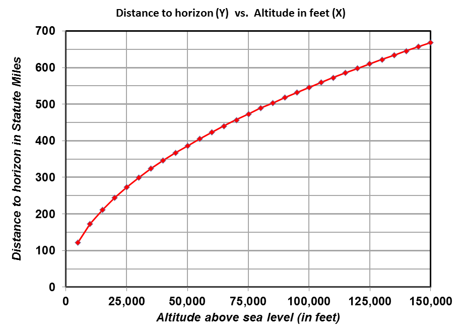

So I hired an 11th grader to work out the trigonometry of the situation, and make a plot of (distance to the horizon) versus (flying altitude). Result is below.
To my surprise, Google Maps says there are 484 miles of Interstate road (which is certainly NOT a perfect straight line) from Tucson to Los Angeles. While the plot below says the horizon is about 500 miles away when you're flying at a comfortable spyplane altitude of 16 miles. So it's quite possible. Golly!
Note: earth is assumed to be a sphere of diameter 7900 mi.

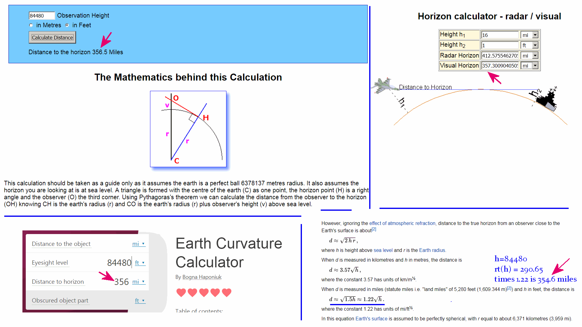

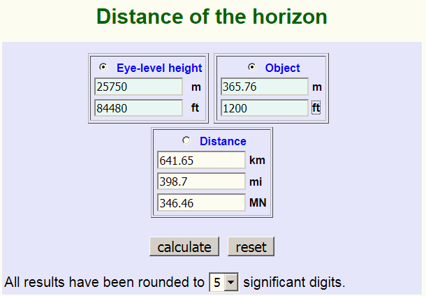

I surveyed the internet. Assuming LA is zero or 1 foot tall, it is pretty consistently 356 miles. I left LA a loooong time ago. Granting it may be 1200 feet tall now, the number is near 400 miles.
{mild over-estimate: Wilshire Grand Center is 1,100-foot (335.3 m), the tallest building in Los Angeles.} {I left LA just before AT&T Switching Center 448' (137m) went up in 1961; we thought City Hall was tall.}
