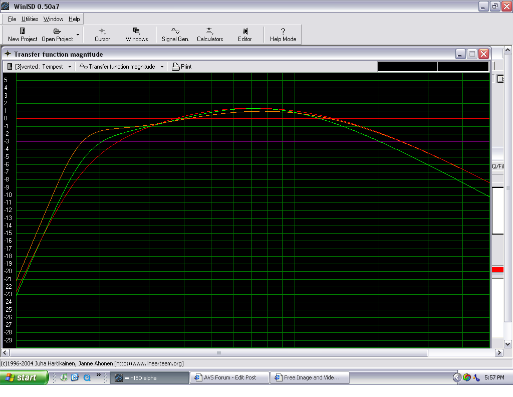

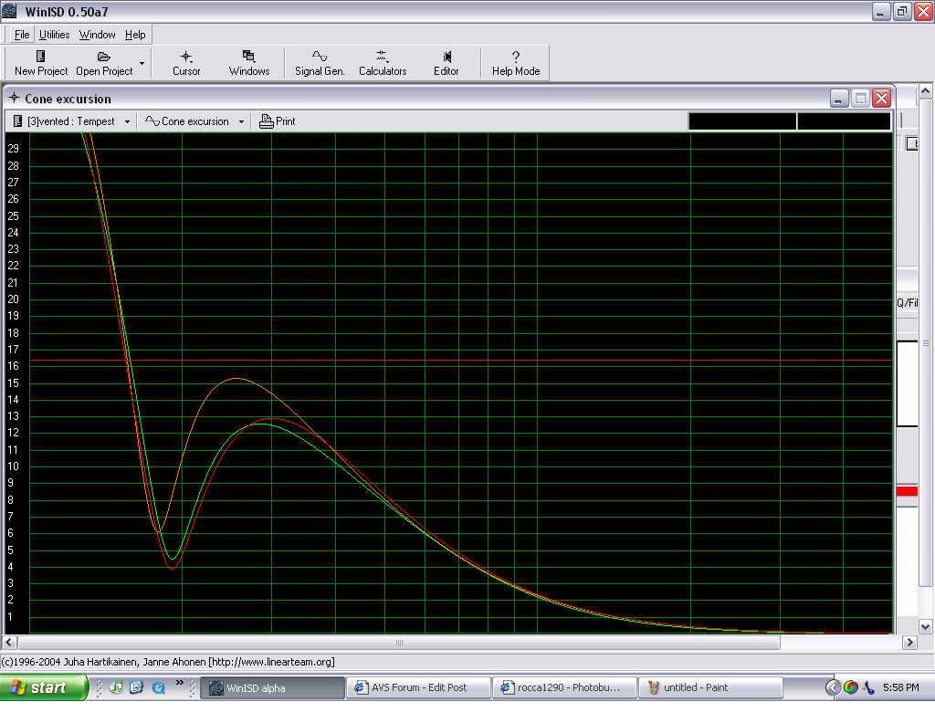

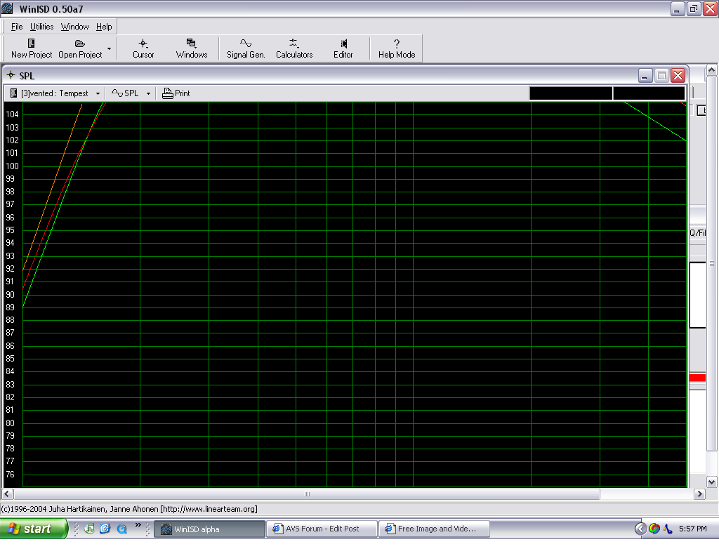

What do you think about this Dayton Titanic project?
Here are the final specs:
Dayton Titanic MKIII 15"
250w Rhthmik Audio Plate Amp (adjustable rumble filter @ 17Hz)
200 liter ported enclosure tuned to 19Hz
And the graphs:
Green = Dayton Titanic 15", 250w, 200 liter, 19hz tuning
Orange = Dayton DVC 15" (Tempest), 250w, 350 liter, 17.8Hz tuning [my original project]
Red = Dayton DVC 15", 250w, 200 liter, 19hz tuning.
Dayton DVC Xmax - 15.1mm
Dayton Titanic Xmax - 20.5mm.
Is 19Hz a good tuning frequency for the Titanic project??
As you can see, I plugged in my orginal DVC project in WinISD except with a 200L enclosure, and 19Hz tuning frequency (same as the Titanic project), and plotted it alongside my Titanic project. It looks very similar to the Titanic Project. Is there any advantage to using the Titanic over the DVC in 200 liters / 250w? I know the Titanic is built better, but will I get better SQ with the Titanic over the DVC (in 250l w/ 250w)?
Any simple changes to this design that you think will make it better, I will be willing to do. How will this compare to my original 350L Dayton DVC design?
Any other graphs you need, I will be happy to post.
--Thanks

For 15" Titanic.
Vb=100-120 L, bigger box - group delay is much bigger.
Fb= 24-26 Hz
Dt=110-120mm
Simulation is.....simulation. 😀
Fb= 24-26 Hz
Dt=110-120mm
bigger box = mroe group delay? i believe ive talked to you about this, and it isnt so. properly designed vented subs can have jsut as good GD as sealed. oh, and i would be surpriused if you coudl even ehar a high group delay at 20hz, if you can even hear a 20hz fundamental.
simulation is simulation, but math is math.
xstephanx said:bigger box = mroe group delay? i believe ive talked to you about this, and it isnt so. properly designed vented subs can have jsut as good GD as sealed.
Example?
example? try VERY low tuned boxes, below FS, and a large box, you can get GD VERY VERY low that way. and where there IS group delay, is below your range of eharing, so does it really matter?
