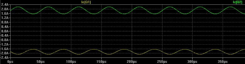

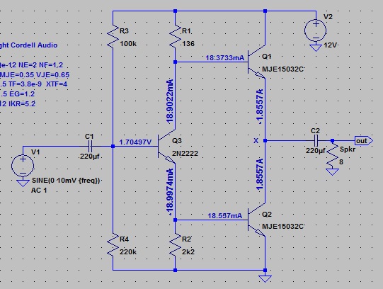

i'm using the following circuit to explore pseudo-pushpull topology, only trying to understand how it works, don't mean to use it for any practical applications at all.
now i have a question. the ac output currents of Q1 and Q2, Ie(Q1) and Ic(Q2), are the same but in opposite directions, going at the same time, as shown below.
so in the output net to speaker, there'd be two currents, same but opposite, going at the same time.
two currents, same and opposite, going in a wire at the same time, what does this mean? could it happen? what did i do wrong in the circuit?

You actually did nothing wrong (though I would have expected the values of R1 and R2 to be the other way round) - you should merely think about your sign definitions again. If current is supposed to go out into the load from both transistors, the Ic(Q1) contribution must have the opposite sign of Ic(Q2). That's Class A push-pull.
Maybe it was a bit unfortunate to plot Ie(Q1) rather than Ic(Q1) (you will find that Ic and Ie are defined such that Ic ~= - Ie).
Homework: Think about sensible values for C1, C2 given a desired 20 Hz - 20 kHz frequency range.

i tried to flip R1 and R2, but i couldn't get the output net voltage to be at the middle of power supply then. this is a minor issue for me now, i'd like to focus on how this pseudo-pushpull output stage works first.

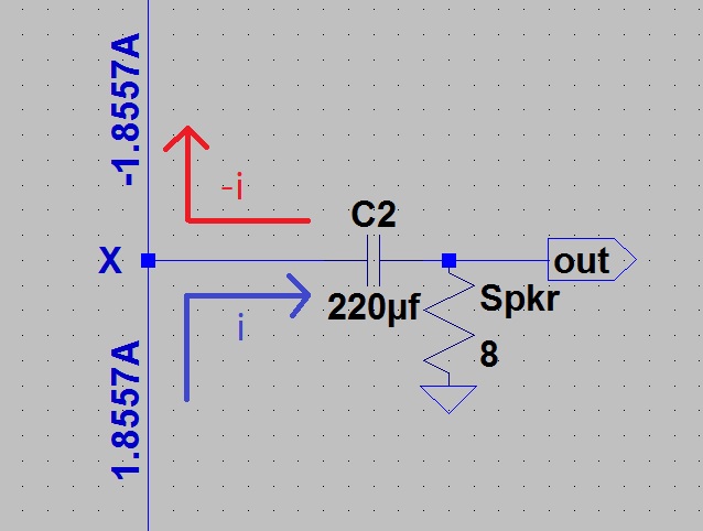

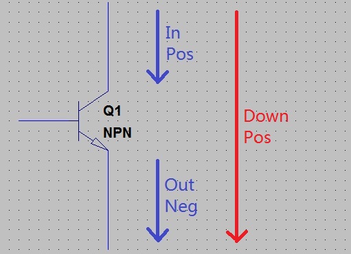

"Ic(Q1) must have the opposite sign of Ic(Q2). That's Class A push-pull. " both currents in terms of Ic, ok cool. that in turn would mean currents in circuit segments A and B be going in opposite directions, as shown in the picture below. that'd leave only one scenario for what would happen in segment C, the two currents would combine and go in the same direction to the speaker. or one current would come out of segment C and split into A and B, then each would go in their own separate ways from there on.
so i now suspect this is the way pseudo-pushpull works, let's call it the working state of such topology. now the confusing thing seems to be LTspice. LTspice seems to always call Ie negative and Ic positive, static, fixed, and always so.
as per the picture below, there is only one current direction with respect to a circuit, blue arrows and red included. but by LTspice definition, there'd be two directions, i.e., there'd be positive and negative directions for the blue arrows. obviously LTspice label dc current this way, as well as plot ac current plots this way, as illustrated in the current plot in my first post. this is what confused me. i was taking the ac current plot as what is actually happening in the circuit, as opposed to current direction with respect to their own bjt's only. LTspice does not reflect what actually happens in a circuit, at least with current? is it really done so? why is it done this way in LTspice?

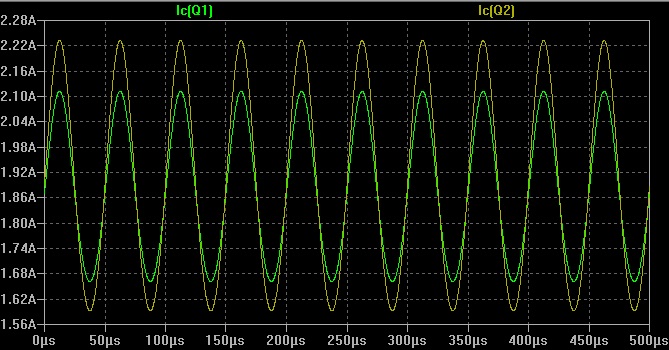

i also plotted out Ic(Q1) and Ic(Q2), and LTspice shows they go in the same direction, not the opposite, as the class A pushpull definition has it, and the circuit is working.
just another evidence supporting the guess that LTspice does it only per its own definition, which may or may not match what is actually happening in a circuit.

Simply, the emitter current is leaving the node (emitter is sourcing the current). And all "sourcing" currents are negative in LTspice (plot Q1 collector current). In fact all simulation programs use this convention and also in datasheet for a digital circuit.

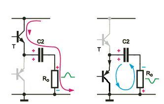

As for the circuit, in ordinary class B push-pull amplifier only one transistor conducts for a given signal cycle.
For positive half cycle the upper transistor deliver current the the load by charging capacitor. And for negative half cycle lower transistor discharge capacitor.
As you can see upper transistor pushing current through the load for positive half. And lower transistor pulls the current from the load.
But for your "pseudo" push-pull amplifier both output transistors conduct over the entire signal cycle. And in this case I_load = I_upper - I_lower.

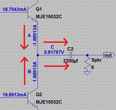

Two currents in opposite directions means that the load current is the differential current. This applies for every PP output regardless of whether it's vacuum tubes driving a center tapped primary, a totem pole OTL (hollow state or solid state) or an OTL Circlotron. No differential current, no output. (And no DC core magnetization for a PP OPT when the finals are drawing equal Q-Point currents.)
In this case, the output from the Q3 "cathodyne" is two signals: anti-phase to the input at the collector, and in phase at the emitter. When the base of Q2 is going positive (i.e. turning on) the base of Q1 is turning off as it goes more negative. If neither phase cuts off, you have Class A operation. If one side does cut off, then it's Class AB, B or C.

if i guessed right, then the way the so called pseudo-pushpull class A work is the two output currents combining into one, going in the same direction into the speaker, or the reverse. could this be a correct guess?

Class A means a duty cycle of 360deg. This can apply to SE designs as well as to PP designs. If push-pull, the duty cycle becomes +/-360deg. For audio, all SE stages have to be Class A as that's the only way to reproduce the entire signal cycle. PP can also be Class A if neither device cuts off at any point in the signal cycle.
The load always sees the differential current.
Yep.PP can also be Class A if neither device cuts off at any point in the signal cycle.
A little example with numbers:
Let's say that quiescent current be 1 A.
Now let upper transistor Ic increase to 1.1 A, and lower transistor Ic decrease to 0.9 A.
Since the upper transistor sources more current than the lower one sinks, the difference of 0.2 A goes out into the load. Each transistor is deviating from quiescent state by 0.1 A.
As you can plainly see, both transistors are conducting at this point, so it's obviously Class A. In addition, each transistor contributes half the load current, i.e. they're working in tandem - push-pull operation.
Things would remain in Class A up to the point where lower transistor current approaches zero (1 A down from quiescent). Then upper transistor current is up to almost 2 A (1 A up from quiescent). So you get 1 A + 1 A = 2 A going out into the load.
You can also look at it another way - if the upper transistor runs at 2 A but the lower one at close to zero current, the difference has to travel to the load (since where else should the current go if the lower transistor does no longer really feel like conducting?).
So with a 1 A quiescent current, you get a peak output current of (almost) 2 A in Class A.
That's a factor of 2 more than a SE circuit, which can never sink more than Iq and as such would be limited to 1 A.
