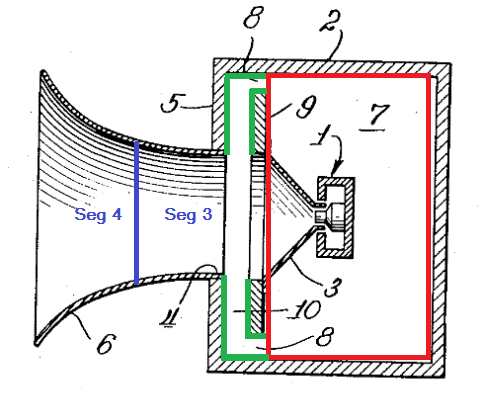

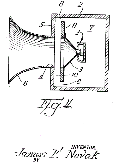

How does one sim a vented back chamber horn whose chamber vents into the throat ?
such as with this case?
Dear David -
I've earned a solid "F" as do not know how to properly input what's needed for a simple throat ported front loaded horn (TH1 w. hornresp)
A step by step explanation how to do it correctly for 1 segment, then the other # of segments hornresp can handle would be greatly appreciated.

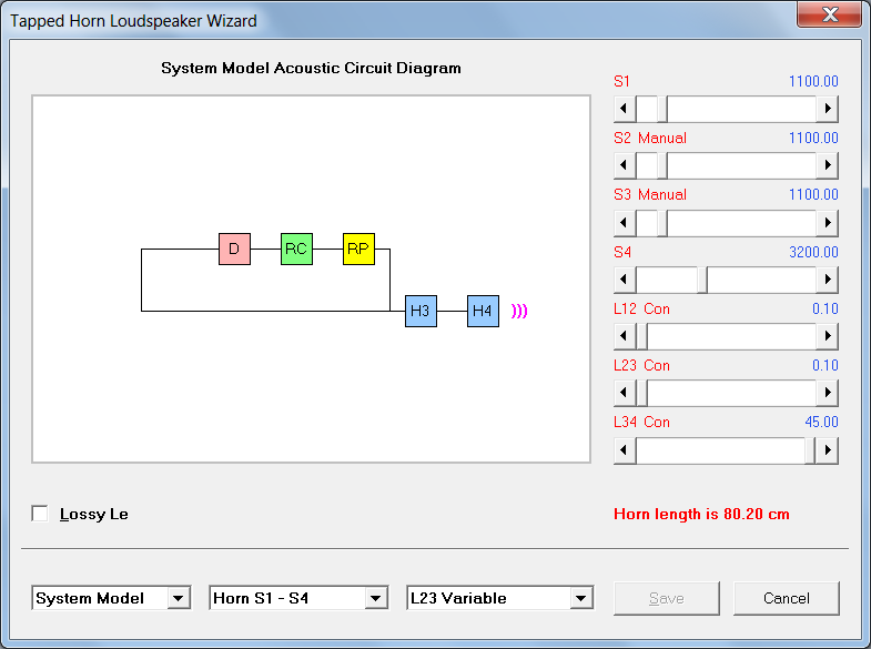

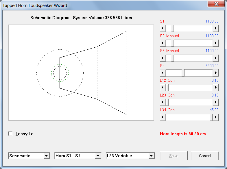

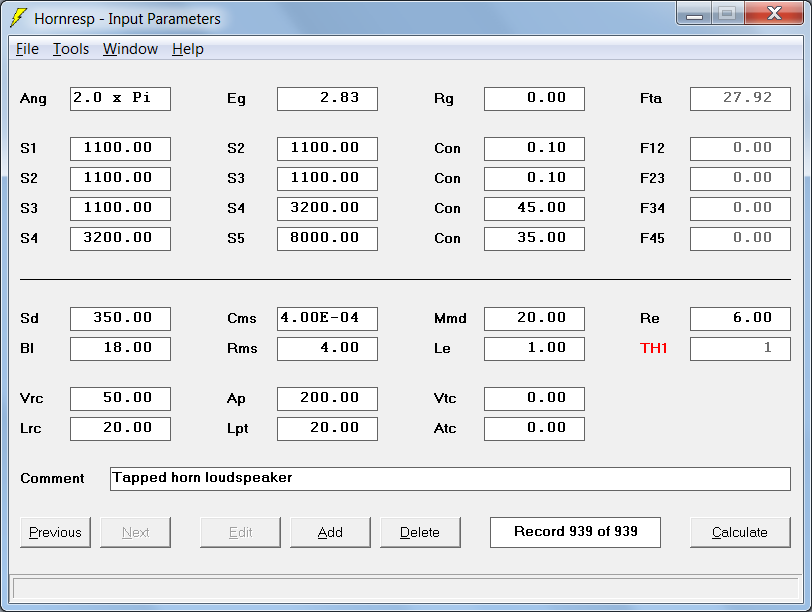

Hi Freddy,
Just because it is convenient to do so, specify segments 1 and 2 as cylinders, each with a cross-sectional area equal to that of the throat of segment 3. Make the axial lengths of segments 1 and 2 very small, so that as far as the simulation is concerned, in effect the segments don't exist (for this reason the actual cross-sectional area values used are not critical). Specify the horn itself using segments 3 and 4.
Attachment 1 shows the standard model for the system. Attachment 2 shows a "modified" system model with segments 1 and 2 (H1 and H2) effectively removed by making their lengths very small. Notice how the outputs from the driver D and rear chamber port tube RP now both feed into the throat end of H3 (segment 3). The red box in Attachment 3 is the rear chamber RC, specified using Vrc and Lrc, and the green portions are the rear chamber port tube, specified using Ap and Lpt.
I hope this helps, but please don't hesitate to seek further clarification if required.
Kind regards,
David

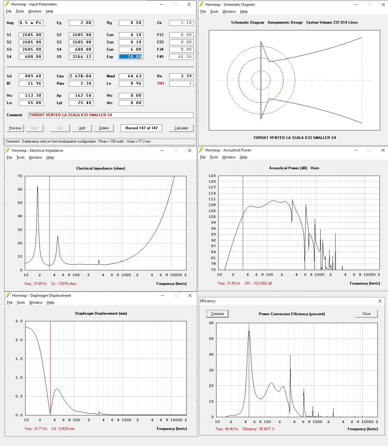

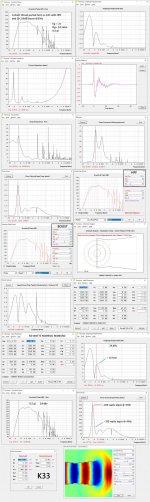

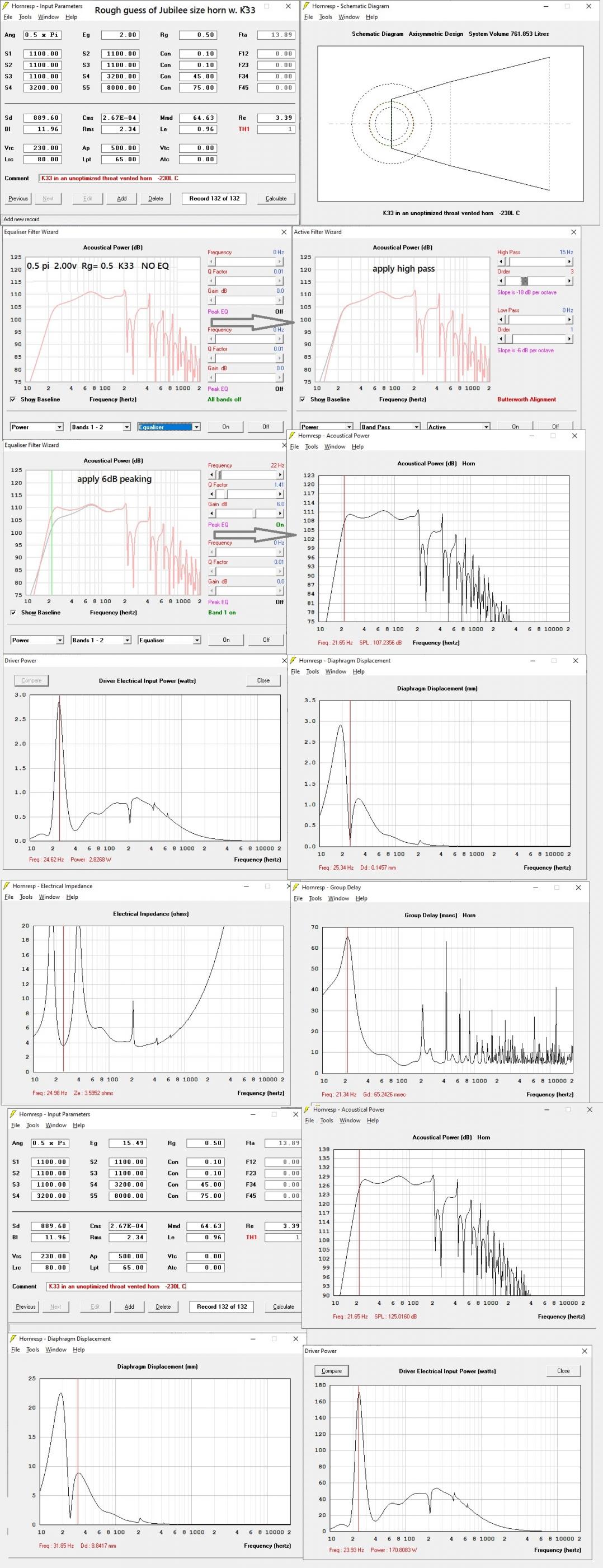

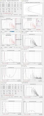

here's a stab - might have goofed in a big way (? didn't have a printer or ruler so held graph paper up the the screen to figure stuff) - its huge
dunno if its even ballpark - could not get the spec of the supposed 12 inch speaker
Thanks David for the detailed explanation.
(Is this arrangement something Brian Steele could put out as a worksheet?)
https://i.imgur.com/8L0PvD1.jpg
just putting in numbers - does this thing look "useful" ? I'm not sure how it would be built even as a rectangular box. Its pretty big.
Baffle = 18.5" by 22.5" and a mouth area like PWK's La Scala
