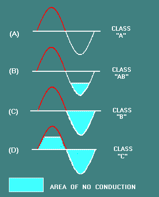

Class Struggle
With tubes, the classes are pretty easy. You know what class A is- the idle current is the same as the max current. (180 degree operating angle)
Class B has an operating angle near zero degrees; in other words, its idle current is negligable compared to max current.
Class AB is in the middle. Its idle current is below the max current, but is still significant.
AB is subdivided into AB1 and AB2: in AB1, no grid current is drawn. In AB2, the grid is allowed to draw current. This requires a heftier driver stage.
By and large, you don't see AB2 that often.
There's also class C, but that's never used for linear amplification in audio. It's very efficient, very useful if you can bandwidth limit it severely, and is commonly found in RF transmitter circuits.

In CLASS A OPERATION, current flows for 100% (360º) of the input signal.
My guess is that the "pure" part refers to the 100% current flow although in most so-called amps it's more often than not not the case.
