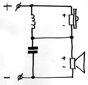

I don't know your level of physics knowledge, but here is a starting point for further research.As someone who is new to this, is there an easy explanation of how a crossover can alter the speaker phase?
When an alternating current flows in a resistor, the voltage across the resistor peaks at the same time as the current. The voltage and current waveforms are said to be 'in phase'.
The alternating voltage across a capacitor doesn't peak until the current is zero, so the voltage waveform is 'out of phase' with the current waveform.
The voltage waveform across an inductor is also 'out of phase' with the current waveform, but not in the same direction as a capacitor.
In the 1st order series crossover shown, the alternating voltages across the inductor and the capacitor will therefore not be in phase with each other. This means that the outputs from the tweeter and the woofer will not sum together as expected at the crossover frequency.
Different orders of crossovers give different degrees of phase shift and good crossover design attempts to minimise their effect.
