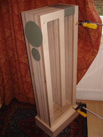

I am wondering what method people use for securing the cables inside their cabinets.
I am just completing my TLs using scanspeak 18w4531. I am basically wanting to avoid the wires slapping around inside for years to come. Maybe this is not a problem.

Mount your crossover part way up your enclosure so the wires go over to the drivers not up to them and keep your leads only as long as to mount the drivers easily. If you are still worried, wrap some insulation around them with tape to make them heavier and stiffer.

Yes, that will work just like insulation taped to it but the real issue is to not have the wires traveling from the bottom up to the drivers in the first place as they may come in contact with the magnets or baskets.
Cal: My crossovers will be in the base (false bottom).
Blue: Nice idea, but I am trying to keep the TL cross-section as close to the designer's specification as possible. I doubt that foam is porous???
I am thinking that "glueing" the cable to the side of the cabs with silicone sealer may be the best way for me. I was looking for a neater way though, or maybe some reassurance that cables do not slap against the sides of their cabinets much.

Apart from a blob of silicone or builders' adhesive where a cable runs through an interior panel, I have never fixed any cables internally, and never had a problem with them rattling, despite making some very high SPL boxes. My advice, don't worry about it.
Ditto. I use hot glue usually, but mainly in MI and PA gear as I don't want it to move even with the abuse/stupidity they suffer at the hands of customers and me: I hate load out.pinkmouse said:Apart from a blob of silicone or builders' adhesive where a cable runs through an interior panel, I have never fixed any cables internally, and never had a problem with them rattling, despite making some very high SPL boxes. My advice, don't worry about it.
