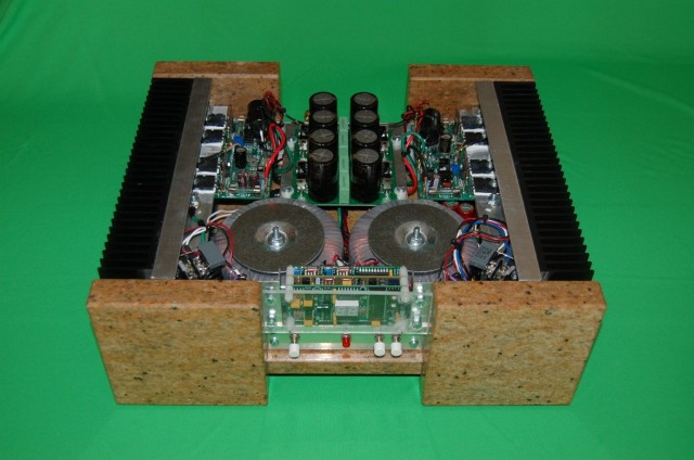

The only DIY products that I know - needless to state there are many more products I don't know - will have no issues with ESL are Hugh's AKSA amps. I recently acquired the Lifeforce 100 with upgraded power supply. It deals with any load in a graceful manner. A stunning amp that really brings out the best in ESL speakers, detail, imaging and, most of all, an incredible ease in reproducing music.
