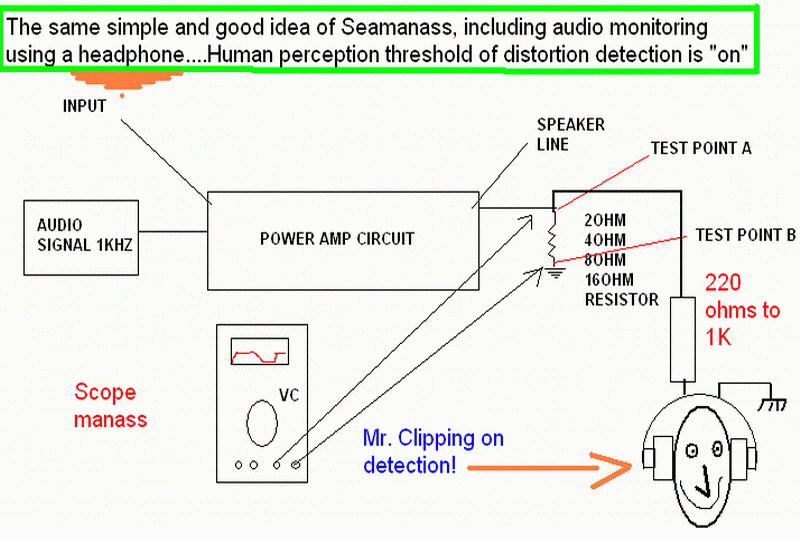

iam not sure if you measure the voltage and amps going into the power amp form power supply or do you measure the voltage and amp at the speaker line out?
Yes, Measure the voltage developed across a known value power resistor.. So make sure your AC mains doesn't sag through the use of a VariAc. Put in 1 kHz (for example) increase the output though a volume control or osc. level control. Monitor the waveform appearing across the load. Adjust output for just under clipping. Check to see that your VariAc is delivering the correct mains voltage. Measure the RMS voltage appearing across the load. P=I2R, E/R =I. or E2/R.

you need a signal source, a scope or thd meter, a set of dummy loads to test your amp. normally it will be the voltage at the output going into the speakers, but since your speakers can get damaged with just a 1watt input, better use a dummy load, a resistor 8ohms and high wattage, say 100watt ought to do it.
measure the output voltage wthen distortion is about less than 0.1% or just when the amps begin to clip isf you have a scope.
be warned though that doing these tests may fry your amp, so proceed with extreme care.

Seanmacss, with your permission i have developed your simple and good metering system
Alternated voltage multiplied by itself and divided by the load.
(Ac out X Ac out) / Load in ohms= Power RMS
Simple, and great!...usefull and complete.
Now with a new feature...the Clipping Human detector.
Life is a fun!
regards,
Carlos
Life is a fun!
regards,
Carlos
